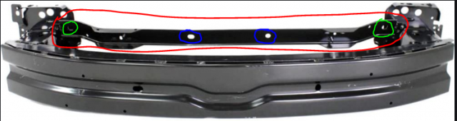

The BA intercooler doesn't mount to the TB crash bar
I cut this part (red) from my stock crash bar with a grinder, really easy to do.
that parts bolts onto the radiator support on the green holes
the BA intercooler hooks up to the blue holes
You could technically make a bracket that can hook up the TB crash bar and not cut that part of the stock crash bar but how it turn on, the intercooler is solid there
If you needed to put the stock crash bar back, you could do so because that part mounts to the radiator support
hope that helps
hope that helps

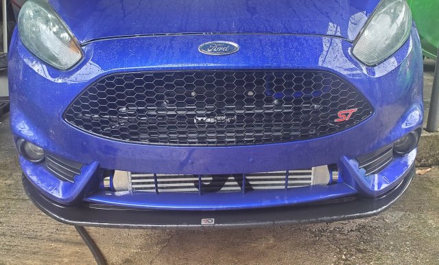

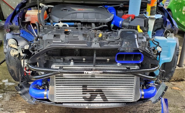

I didn't take a lot of pictures when i installed it but this 2 i think would give you want to look at.
Ps: i know the emblem on the is not centered on the front lip/splitter, it came like that from maxon.
You are a real Jerk.....Now you got me wanting the bar and really making me wanna shave my grill down! You said you had to cut the crash sensor bar and re-attach it right?

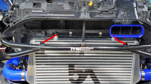

I guess that is the easiest and fastest method of doing it.
After cutting the sensor bar, it basically bolts on to the radiator support.
It is already secure with bolts to the radiator support even while it is soldered to the stock crash bar.
Or if you can make a support bracket that looks like this (the red thing), that could work also and not cut anything on the stock crash bar.
If you do that, you would have to place somewhere the 2 sensors that are on that bar. I dont know what does 2 sensors are but i am thinking it for crash sensor? idk
Those are impact sensors...they control the airbags when you get into an accident. I am leaning towards a Gold BAR. How long did it take after it was ordered to be at your door?
Gotcha! Quite a clever way to do it tbh. I was skeptical how the universal intercooler tabs would work. They would but I wouldn't like that setup. I'll definitely be doing your setup by cutting that part of the stock crashbar off and reusing it.
Where did you source the blue intercooler hoses from?
Also, why does the hood latch rod not look straight? Or is it the picture
the picture is taken kinda crooked + I have to resize the picture because cellphone pics are kinda huge, so it not doing any favors there
I just replace the included black 90-degree hoses with blue ones from eBay.
The other hoses are the blue boost silicone hose kit by whoosh
