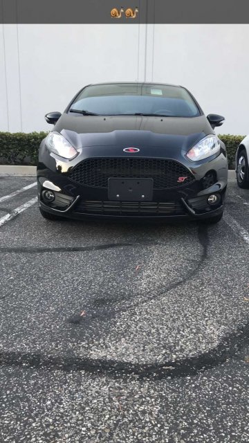

recently got a new Fiesta ST and was wondering if anyone could help me out. I'm fairly new to modding cars and was interested in what mods would actually void a warranty. I would eventually like to add some HP and Torque a bit. Nothing too crazy... but being a bit faster would be fun in this little thing. Anyway, I will be looking through the forums, as I am new to this as well. thanks in advance!

I definitely will be look into that! Looking to go to any local meetups if time allows it. I'd love to meet other Fiesta ST owners...
I've had the car for a little over a month and I love this thing!

Congrats!!
What will and won't void the warranty is a tricky thing. If the dealership can point to something you've done as having caused the problem, that will void it. Tune using a Cobb Accessport? Definitely can void your warranty.
I would do your due diligence, look into the Moss-Magnussen Act, and know that whatever you that's not cosmetic has the potential to void your warranty.
That all being said, I went stage 2 w/ a tune from Dizzy and just got a new transmission under warranty. Did the time cause the transmission bearing to go bad? Probably not. Could Ford have said that I flashed a tune onto the ECU and added power which put stress on the transmission and this void my warranty? Maybe.
Have I put any of my tune stuff back on? No, and I'm not sure I plan to. I like the warranty paying for stuff that breaks.
A lot comes down to what all you've done and the dealership you go to.
Best of luck and welcome to the forum! [emoji322][emoji322]

Honestly, the engine itself is near bulletproof, it has been pushed to nearly double its stock power quite often, safely. However, sadly, as you shouldn't HAVE to on a new car, one of the first things you should do is replace the transmission fluid with 2L of an approved fluid. Either the Ford OEM that is actually DCT fluid, so I decided to go with Ravenol MTF-2, a Ford approved gear oil. They are often quite infamously under-filled at the factory and it's a pain to convince Ford that they need to check it new so it's best to just do it yourself. You will avoid gear whine and complete failures this way.
If you just want a little power, nothing wrong with going with a Cobb Accessport and running their free Stage 2 (their mod requirements for Stage 1-2 are meaningless) or adding a Dizzy Stage 1 should be quite safe. Most people upgrade the rear engine roll restrictor, what we call the "RMM" to handle the additional torque as we have such a tiny turbo, it makes tons of torque easily.
Congrats on the new ride! I got mine 16 months ago and still love it! I ended up doing more mods than I thought I would, just keep in mind traditional mods like intake and exhaust add VERY little power, just a 30% ethanol blend tune maxes the stock turbo out without any mods, but an intercooler upgrade, especially in sunny and warn SoCal would be the one to consider the most after your RMM.

Welcome! It's a fun car, bone stock.
There's a huge aftermarket, so your only limit is what you're willing to spend.
Take your time and read up on what people have done, and keep an eye on the classifieds.
Break it in, change the oil, and just get used to it, then start modding slowly.
