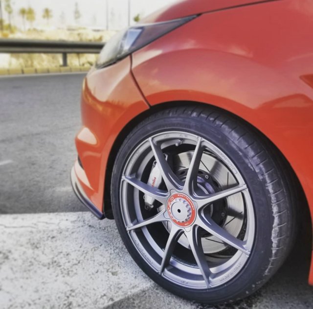

The ST brake system is undersized from factory, mainly the front discs are too small and don't provide enough heat capacity. EBC pads aren't really cut for track work either, no matter what people say.
Before going with a BBK, I would try G-Loc R12/Carbotech XP12 front & rear with fresh brake fluid (Endless, Castrol..). That may be just enough for some people. Personally I still faded that setup after 2 laps at a 2 min track, with visible heatchecking on brand new discs, on STOCK TIRES, so I went BBK.

what did you end up going with?
