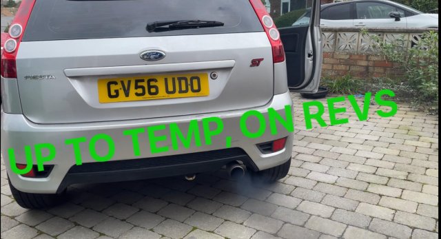

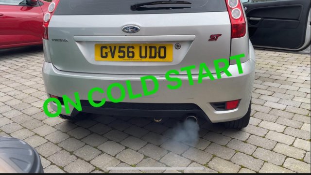

Yesterday it failed the MOT on emissions and according to the tester, filled their garage up with smoke when doing the test. Cold start it still has a bit of white/blue smoke and after coming back from a 15 minute drive today I got my son to video from the back and there is a lot of black smoke on revs.
My thinking was that maybe there is a load of oil stuck in the cat & exhaust that might be burning with the smoke possibly? Other than it being piston rings, any ideas on what could be causing the smoke?
