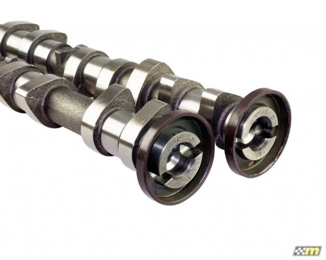

how cool would it be if we could rig up a rotary-style fuel pump that works off of the exhaust cam, similar to the vacuum pump on the intake cam it can be driven by the key hole at the end of the camshaft.

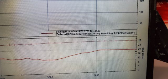

You can make upwards of 340whp with just injectors alone in optimal conditions. 330whp should be no issue. This is with an s280 turbo. The road used for this datalog is GPS verified less than 1% negative slope.
I am interested to see other similar setups with only the injectors and no HPFP.
Maybe your car is just an anomaly of a beast. lol.

I too would be interested to see more examples. I don't think there is anything special about this particular car, to be honest. I am running an e30 blend. Our local E tests at about 65% and im mixing the rest with e10 91 octane.
