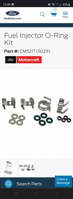

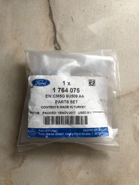

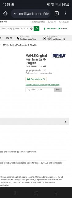

So to run these we need to change the seals?
seems so. you could run it as it is (like people do with the non-double sealed that the shops sell)but you have the risk. as far as i understand you also need some kind of tool to put them
see the video and you'll see him showing de difference between the seals
