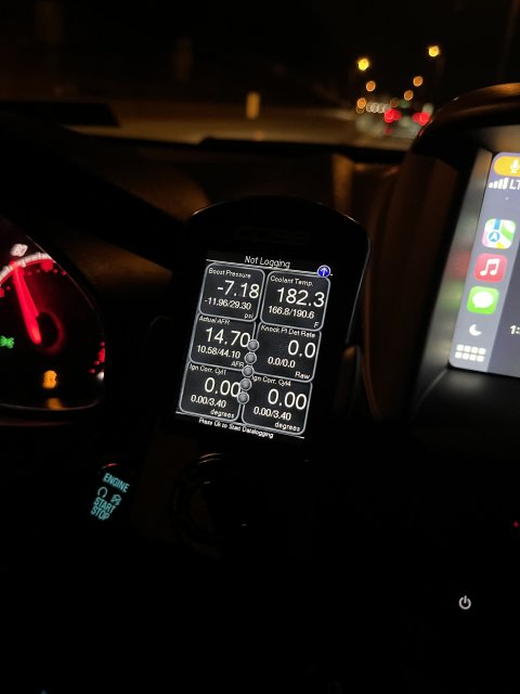

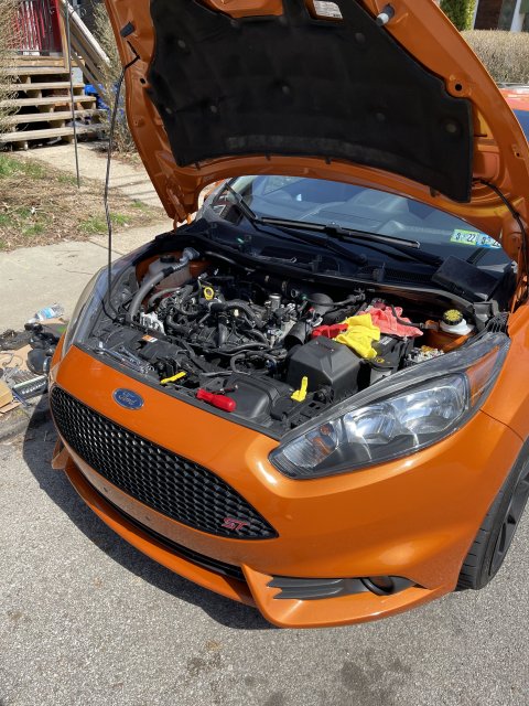

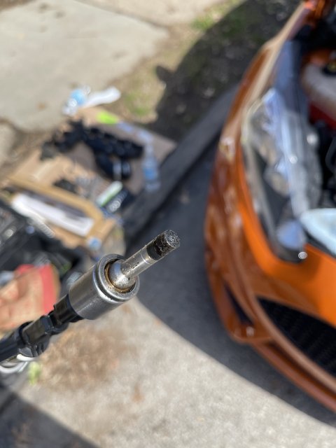

Just installed these last week and we’re already done with tuning after 4 revisions. Car pulls like a freight train on an S280, god damn. Just wanted to share lol. Also my injectors were dirty AF. I need a walnut blast!
Logs look great and there’s minimal fuel rail pressure drop so my stock HPFP is handling things just fine on 93. I imagine ethanol will change that, but the motor is getting sleeved and built this summer first, then HPFP and -all the boost-
car made 276whp/314wtq on stock fuel and now I have no idea what it’s making with the injectors but it feels REALLY good

The injectors Don't live in a very clean and friendly environment. So it's pretty typical of them to be dirty. I'm starting to wonder how nice looking mine are. Maybe I'll join the 30% injector band wagon soon enough....most likely when my DHM setup goes in so I don't have to pay another $250 to make a major change to my tune.

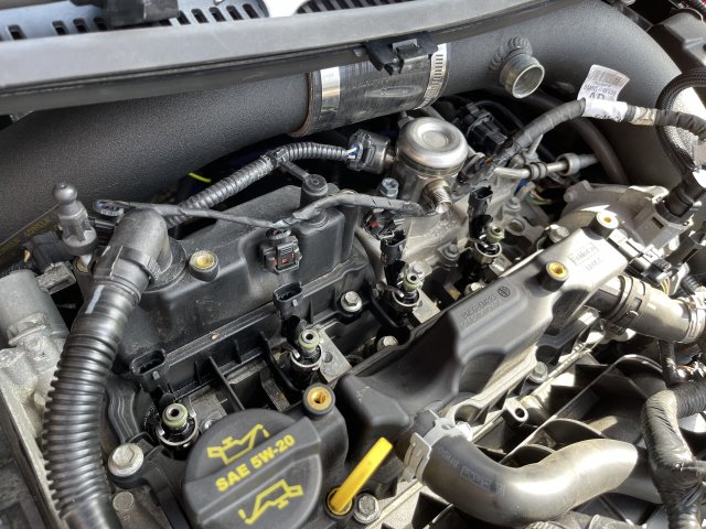

They're actually really easy to pull out by hand, just a wee bit of wiggling. Installing them is a bit more difficult. Go by feel, and make sure all 4 injectors are at a very similar height. You may have to wiggle the injectors down into their orifice. It's a tapered seat, so it will feel very tight with the injector seals installed properly.
You need to make sure you have the resizing tool for the seals, otherwise it won't work

I just installed the Jag injectors without any of that stuff. I just rented a 5lb slide hammer pulling tool from AutoZone. Mine were pretty stuck. I switched over the metal spacers from the old injectors and popped them in. Did some custom work to install the Jag HPFP. Buttoned up everything and crossed my fingers.
