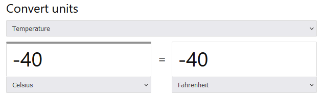

Regarding that specific number...
...it appears that specific number is THE number at which both C and F are the same...
...so that makes me wonder, what does the climate system read for a disconnected sensor?
