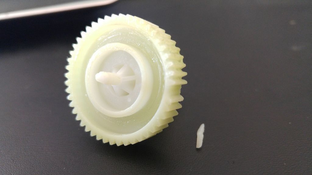

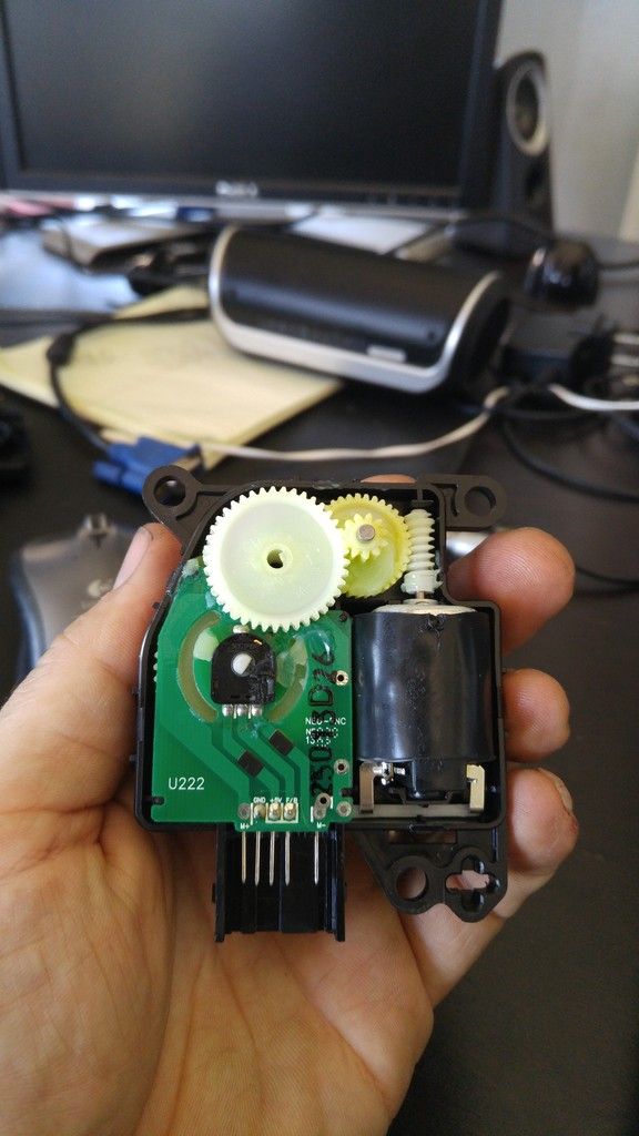

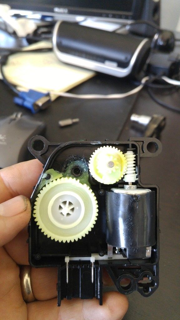

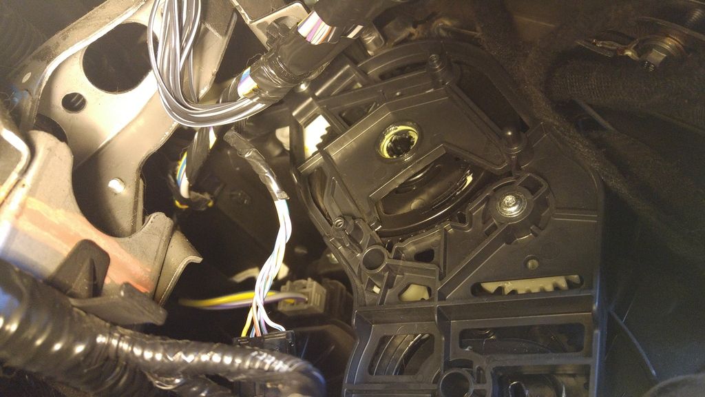

Alright. I finally got a chance to remove the offending part. as shown between the steering column making this clicking sound:
http://vid66.photobucket.com/albums/h270/sabrelime/20160208_080403.mp4
I had it out in about 30 minutes.

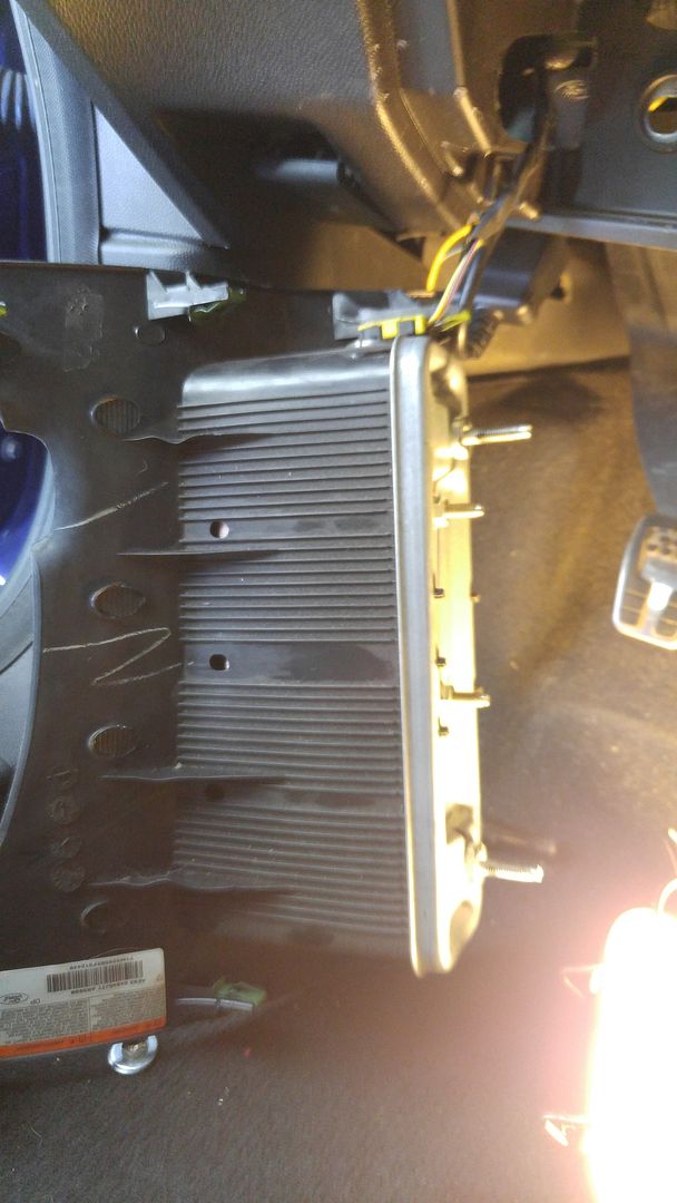

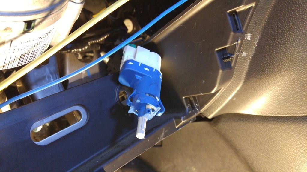

I took out the seat, then one of the brake pedal sensors, then the knee airbag units, and then you just have to snake your hand up next to the steering column with a 1/4 inch ratchet and a 7/64 allen bit and remove two screws.
Here is the brake pedal sensor. You can remove it by twisting it counter-clockwise with the little blue tabs on the side of it:
This allows you to remove a very difficult to reach 10mm nut holding the console side of the knee airbag in place. There is another 10mm nut on the opposite side that is easy to get to. Then you just pop out the plastic tabs in from to pull back the airbag:
You unscrew the actuator motor leaving this hole:

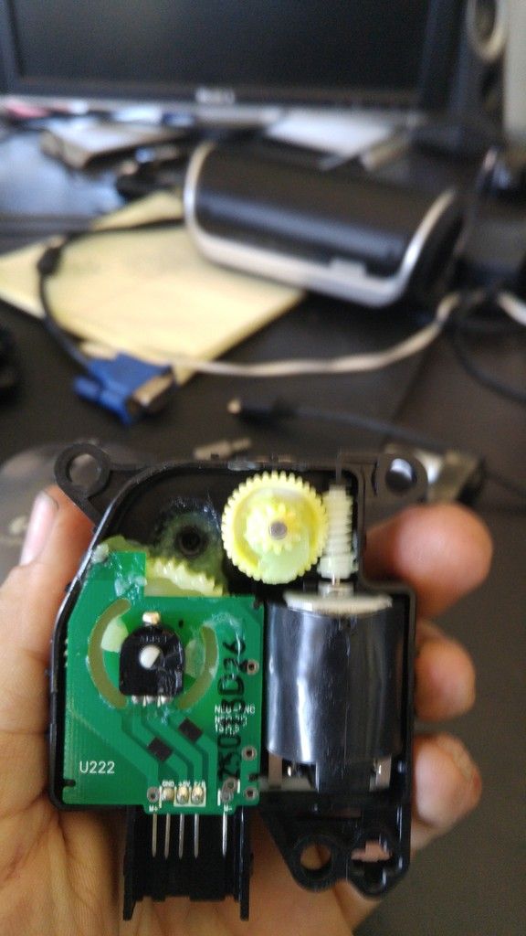

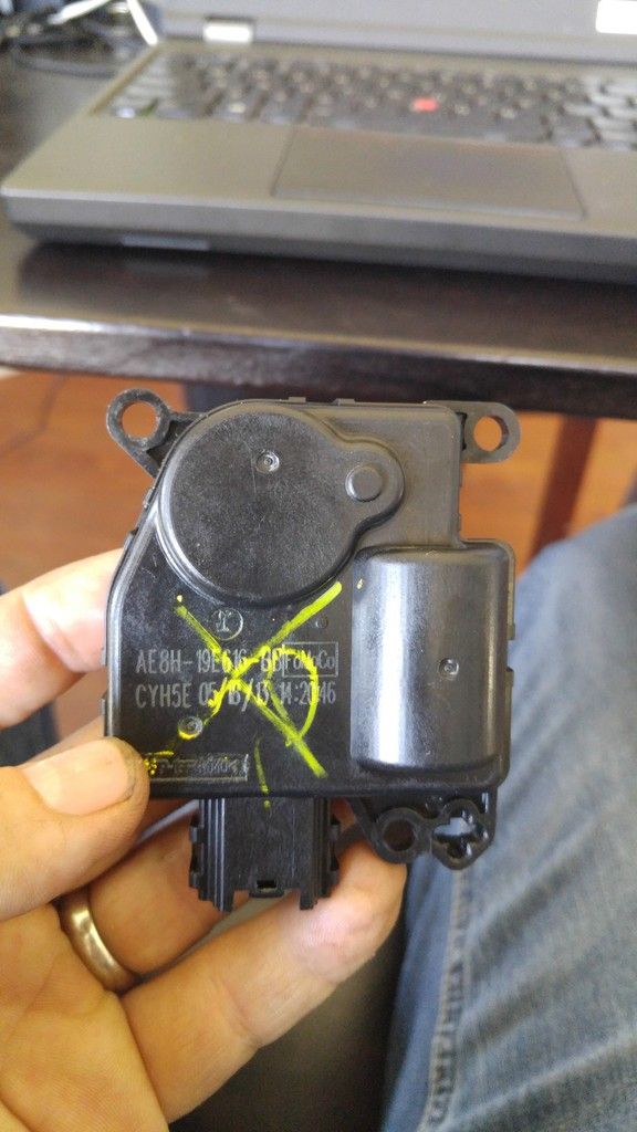

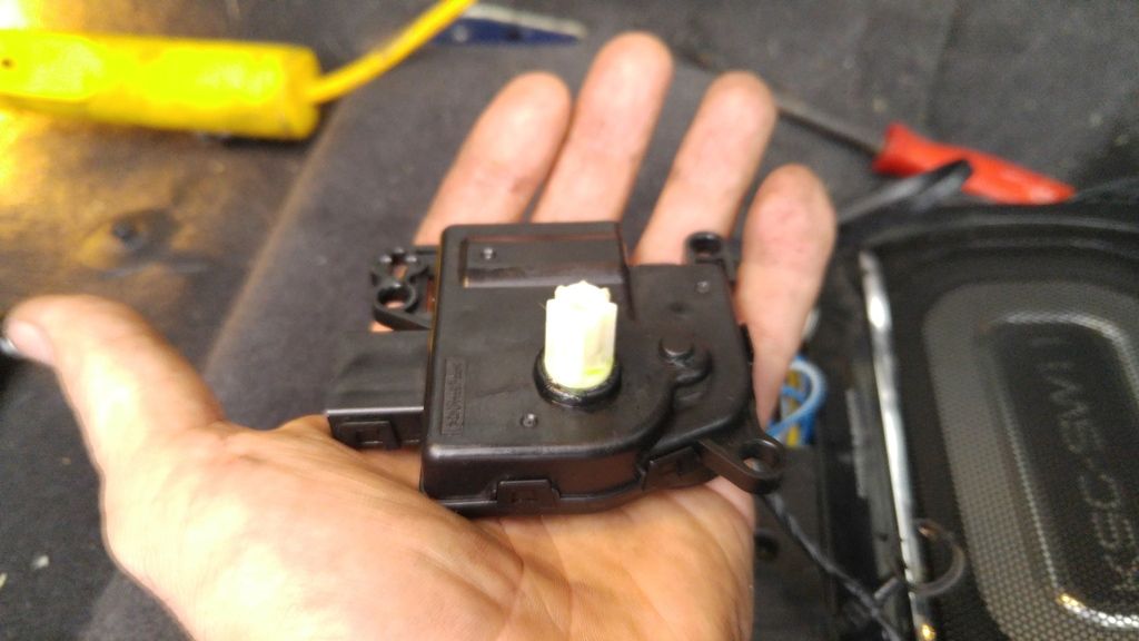

Here is the actuator:
Its the exact same one as one they are selling on ebay for a 2011-2014 fiesta Actuator for $19.99: http://www.ebay.com/itm/221522180489

I just thought pictures and instructions would be helpful to members in the near future as warranties expire and more and more people end up having to do this. It sounds like it is a pretty widespread issue.
Outstanding post. Decent nylon gears would not fail like that so soon.
Mine is still under warranty but now that I visualize the problem, I will repair it myself rather than risk dealership messing something else up.
