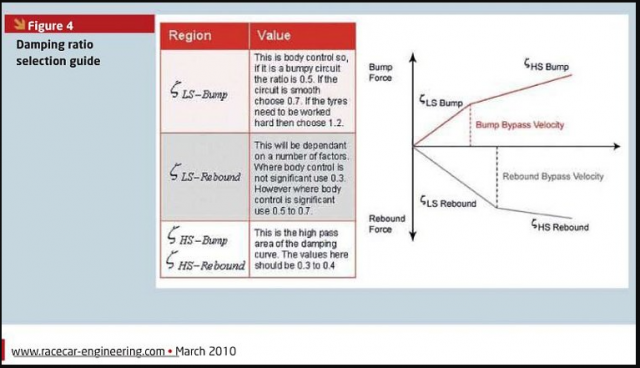

Now, as it turns out, anything that goes up must come down, and so to maintain road contact at the ideal natural frequency, we actually want nearly symmetric damping in the 0.5-0.7 range. Here is an example plot from one of many shock tuning guides:

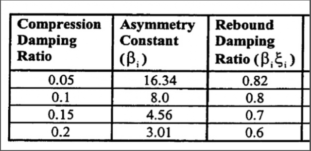

There's this persistent myth in the aftermarket that the way to make a car handle well, we need a metric shitton of rebound damping and less compression damping. This is unfortunately one of those things that sticks around. It has its basis in design for much more softly sprung passenger cars and trucks with very soft, often linear compression at 5-20% of critical. To keep such a comfort based setup in contact with the road, you do need an excess in low speed rebound 60-80% critical, or between 3x and 8x times compression damping, just to keep the suspension from being underdamped and oscillating uncontrollably. Obviously more is better right and we should just turn the knob to 11 and keep the same ratios.
It turns out this is not true. As we increase compression damping to improve body control to the levels you want for a performance setup, we actually want to *reduce* rebound damping, or else we will actually reduce grip by increasing load variation on the tires as the car body gets closer to critical damping
Here's a near post that talks about it and a table pulled from a paper it references which is actually referring to over the road trucks, and limit load variation to reduce damage to roads. But it turns out that to optimize grip, we actually want the same sort of thing (consistent tire loads), but with better body control. It is fairly simple to extrapolate the results until you reach the graph and 0.5-0.7 values above.
https://edfishjr.com/2020/12/27/basics-of-shock-tuning-2/
So there are basically only a few situations in which you actually want to dial up for high amounts of assymetrical rebound damping nearing or exceeding critical levels.
1) You are tuning an OEM car or truck with comfortable springs and light compression damping
2) You are tuning a "jack down" setup with either progressive springs or MCU bumpstop "spring aids". This is common in autocross and stock classes where you are allowed to change shocks, but are restricted to stock or otherwise limited spring stiffnesses.
3) In autocross, drift, tarmac rally and/or gymkhana setups, where you need to emphasize quick transitions or you don't need to maximize "grip" because you are sliding tires and chassis control is the overriding priority. Sometimes in wheel-to-wheel racing, you might also want to give up a little grip to improve body control as well.
For any street performance, track or racing application, you're better off going for a more stiffly sprung setup to reach the 1.8-2.5Hz range (not exceeding 2.5 Hz), and increasing compression damping along with rebound, but staying below critical damping rates. If you want more body control, add stiffer sway bars to adjust chassis balance. Tuning in little bit of extra damping is okay, but don't go overboard. You'll end up with a setup that gives better traction *and* better ride quality than a heavy rebound biased design.
A jack-down setup with heavy rebound is still a legitimate way to tune a car, especially for autocross, as long as you're aware of the downsides and know that you're doing so intentionally

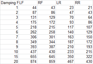

Hey Brett, was wondering if you would be willing to post your after revalve dyno plots? I'm trying to figure out with what I want to go with. I've slowly been cheaping out on my suspension as I've gone through cars. I had Hotbits DT2's on my old Galant VR4. That was gloriously adjustable. The CTS-V got FEALS 441's. Part of the attraction of the FEAL suspension other than they do good work for the price is Odi, had a CTS-V and nerded out and did all the development work in making a great package. Its decently valved for spirited driving and I can tweak it some on track days to extract the balance I want.
I just got some B14's for a song. They are used, but seem be in good condition based on previous owner description of use and driving them. I feel like with the few hundred miles I've put on the setup that I want a tad bit more compression to slow down the g out effect I get on big dips. I feel like the spring rate is about what I would want. I haven't gotten into borrowing my friends scales and going through dynamics calculations. I'm assuming Bilstein spring rates are close to flat ride frequency ratio since I don't notice any pitching issues as far as comfort goes. I'm really trying to avoid nerding out and going head first into suspension (Mechanical Engineer major, and I did lots of work with our schools FSAE car). I already have too many hobbies and a young family that deserves my time.
Once I can iron out what I want from this suspension I'll bring my list of demands to a business in town that just so happens to specialize in Bilstein (https://deltavee.net/). One last concern on the B14's I was thinking about is changing out springs. I feel like having to max out preload to minimize drop to my preferred ride height isn't ideal. So I'd need to source linear springs in a slightly longer size and change spring mounting hardware.

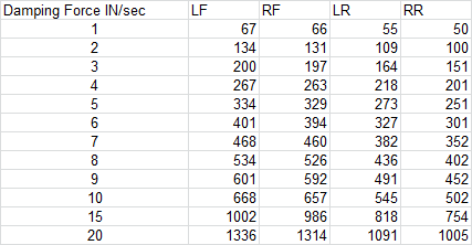

I am on day one of driving and its better, but I think the front dampers need a little more bleed as I am getting "short cycling" on the slow shaft speed dips and bumps. Think 20mph or less and just low spots in the pavement or small cracks and such. Feels like the rebound stops the car from making the necessary cycle for "comfort". Will keep driving and see how it feels now.
I'll get a damper curve today.
