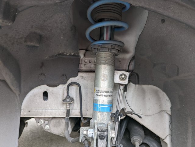

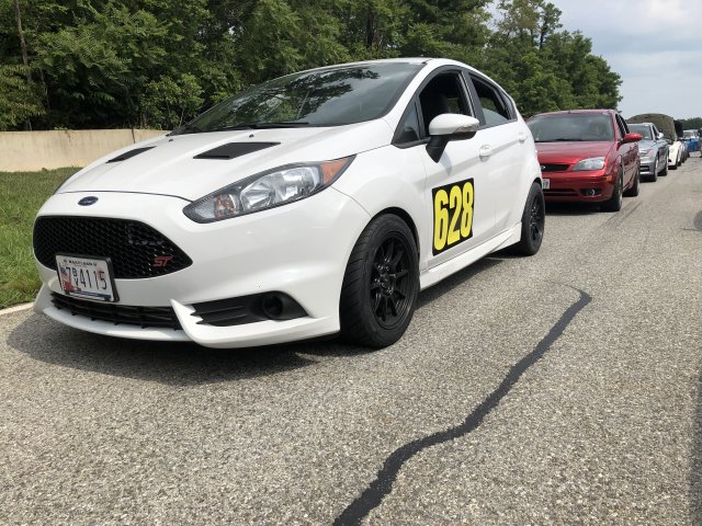

That would be sweet, but so far you're the only person who thinks that they will fit. This is as high as the front goes.
You are on a 23.4" tire in that photo if that is the stock sized 205/40R17 tire on a stock 17x7 wheel. Remove .4" of an inch from your current tire for a 205/50R15 on a 15x8" wheel.
It is literally the exact same setup as a b-spec race car.
Bilstein references 25mm lowering up front and 20mm lowering in the rear. That is less than an inch...
For reference....my car on 15x8 +35 Dekagram with a 225/45R15(23" tall) on Swift Spec-R lowering springs which lower the car around 1" back and front.
and doesnt even rub when youre tri-cycling it.

I don't know what a top hat is or bearing? I'm using the "non" ST kit (BIL47-167490). In the picture this is the highest the car will go on these coilovers which is about 2" (50.8mm) lower than stock. I had the car lower which gave a much better ride, but raised it up because I keep hitting the splitter on every driveway
Then something is wrong with them as you should have significantly more available height than 2" lower than stock. Bilstein states 25mm up front and 20mm out back as the minimum drop from the OE Fiesta(not even the ST) height.

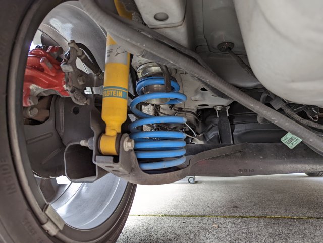

Can you take a picture of the strut and spring/shock combo in the rear? Picture of the adjuster and spring would help to determine what is going on.
Stupid question, are you turning the spring collar up or down? Collar should be at the tippy top of the damper for the least amount of drop. Pictures of your current collar height will tell us where youre at.
I'll grab pictures over the weekend. From memory the collar was at the top and I went a thread or two down so it wasn't at the tippy top.

The rear is certainly as low as it can go. Spin that collar down to raise the rear up.
The front looks like its in the top end of the threads but not all the way up. See below for mine which has more threads available to raise the height and which makes it look like you have a quite a bit left(maybe 1" worth?). I can measure the full threaded portion and let you know the full length of adjustment but it would be easier for you to just spin it all the way up and drop the car back down to see how much it raised the front.

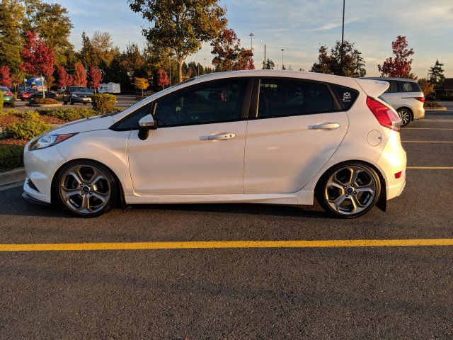

Did you re-spray those 1.2s, or is that now a factory color?

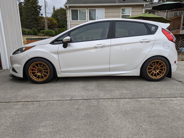

Is this a higher ride height than you had before, or were you never able to get it any higher from earlier posts?
24
9
Milton
#34
Factory color and it's about 1/8" higher. The fronts are now maxed, and the rears have plenty of adjustment.
