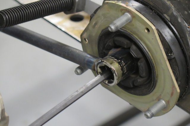

wow nice, never seen this kind of sockets before, need to buy for sure, thanks for the tip

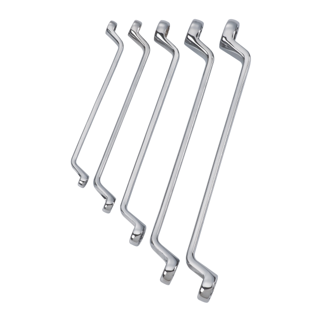

That or an offset wrench can do the trick as well but you'll end up paying near as much for just one 18mm wrench than what you'll pay for a pass through socket kit.
