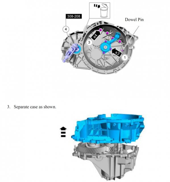

Input shaft seal while you are at it. Part # AV6Z-7048-A
The case half where the input shaft seal is located has to be lifted off from the rest for install. I wouldn't feel comfortable reusing it.
The seal is behind the slave cylinder.
