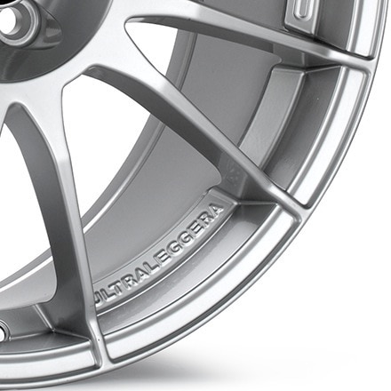

From a layman's perspective, I'm just looking at the curve and thickness of the spokes for now. These are OZ Ultraleggeras and they look like they have a fairly thin spoke which also curves in such a way that it appears to give good caliper clearance.

Thanks also for the pics! The pic doesn't show the BBK, but your signature does. I'm assuming the above pic is pre-BBK and that the wheels still fit without a spacer just fine?
In any case, TireRack has confirmed that the 17X7 OZ Ultraleggera will clear the Wilwood BBK.

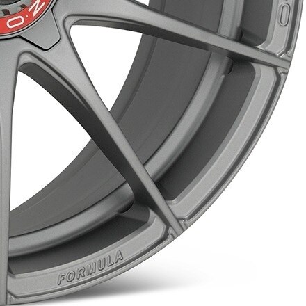

My OZ Formula HLT wheels give me quite a bit of clearance. I can fit my index finger between my wilwood caliper and the wheel. [MENTION=1536]LeonardSkeonard[/MENTION] also has some Kosei K5R wheels that actually provide more clearance than mine.
