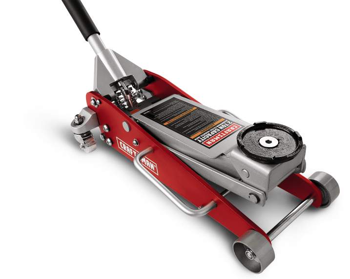

I'll see if I can snap a picture for today or tomorrow. I've been using the jack point behind the front tires with my Craftsman 2 Ton jack. It's large enough to lift both wheels off the ground at once.
