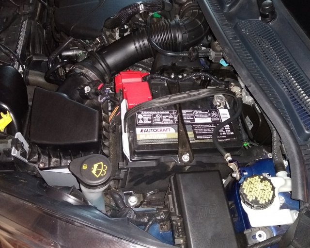

I just ordered the Group 96R AGM battery from Advance Auto. I want the peace of mind of a battery that can't leak, that whole apparatus and fuse on the positive battery terminal looks like it could get really messed up if the battery did leak.
When I started this thread it was called an AutoCraft battery, now it's called a Diehard, because Advance Auto evidently bought the Diehard name. According to a guy I talked to at a local Advance Auto it's the same battery with the same part number, just rebranded as a Diehard.
If you sign up for email it's only $159, although you do have to take your old battery back to get your core charge refunded-

I bought the Advance Auto Group 96R AGM battery online, and as I said above,on Advance Auto's website it's now branded a Diehard, but the one I got is still branded an Autocraft. Advance Auto says it's an identical battery, just a difference in labels. It bugged me at first because it kind of seemed like false advertising, but after checking with them they convinced me it was in fact identical so I decided not to worry about it.
The guy at the local Advance Auto where I took the old battery to get the core charge refunded said the part number is the same, and the specs appear identical. IMG_20200825_163200276.jpg
