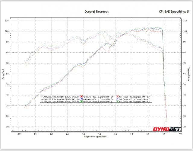

I can confirm the lack of torque lol. My car put down 104whp and under 100 torque to the ground.

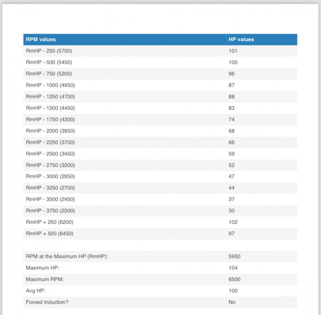

Do you have a dyno sheet? I feel a torque dropoff right before 3500 rpm and I was wondering what that was all about.
Of course, I have 2 pictures for you. One of them is a classing form for NASA time trial competition.
This car is 100% bone stock engine wise. Even the intake filter is still oem.

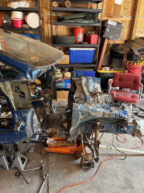

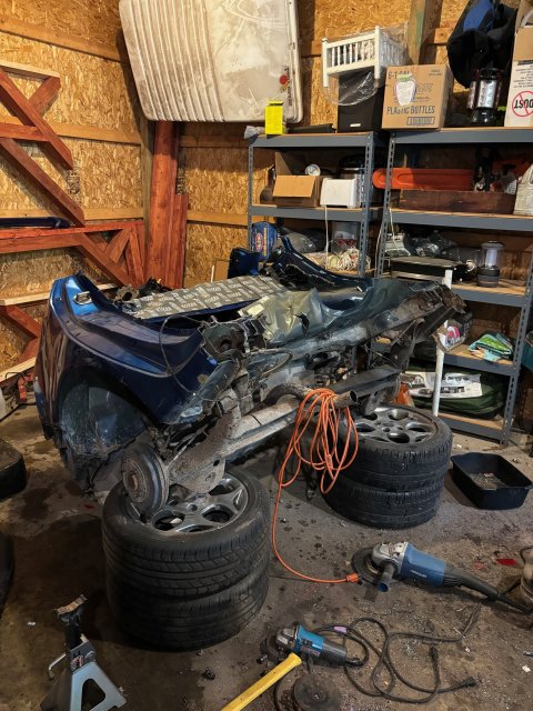

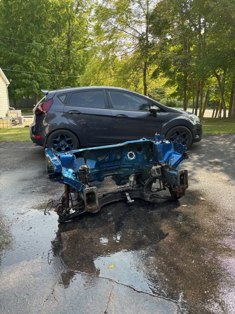

Got a bit more progress:
Cut the hell out of the doner car and got what I needed off in one piece.
I put the engine and trans back into place so now I can work on storing it over the winter. Not shown but I have the dash out and most of what else I need removed too. I think even with school and work I’ll be able to get the rest of the car out of the garage by my deadline. Much less of a problem now that I have what I need.

Thread Starter #50
Decapitated that mf. Looking forward to it finding a new home in the back. How much of the rear has to be cut out to fit it?
I’m not exactly sure. I’m cutting up a sedan so the back end isn’t the same. My plan is to strengthen and slim the piece I removed so it will have a smaller footprint in the rear. From my eyeball measurements it’s going to fit perfectly. My logic is that’s there’s plenty more room in the rear than the front. My subframe may be visible from the bottom rear but I’d like to hide it under the bumper cover at least. We shall see.
