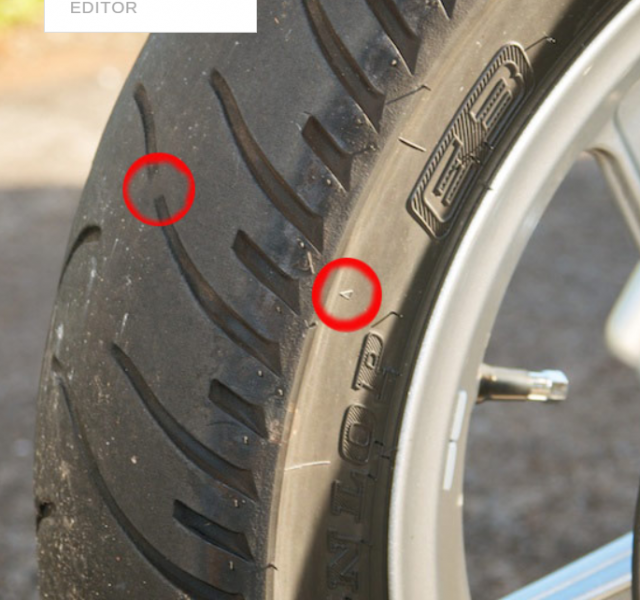

If you have something to take tire temps, is hard to tell you what pressure you should use. every tire is different. is also affected by how hot it is or even what type of track.
If you don't have any tools and only a tire pressure gauge, drop all tires by 5 psi over stock and put some type of chalk on the wear marks on the tires. Do a run and when you enter the pits, check the tire wear marks, if they are over the wear marks, you need to add more air if you have space between the wear mark and the wear of the tire, decrease the air. Adjust by 1psi and do a run again
This is a bike tire but is the same on car tires. See the triangle marks on the side of the tires, that is what i am talking about
