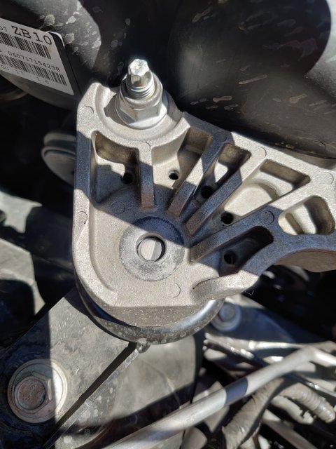

Does anybody know what the bolt size is mine just broke and I need a Band-Aid for my daily driver. I ordered the new one from woosh. But it won't be here for some days and I need to work wondering what the sizes are maybe I can get a bolt from home Depot to hold me over a couple days
M12x1.75

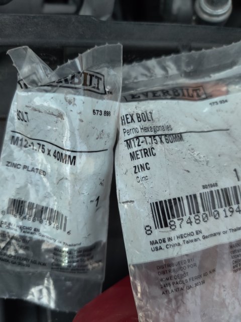

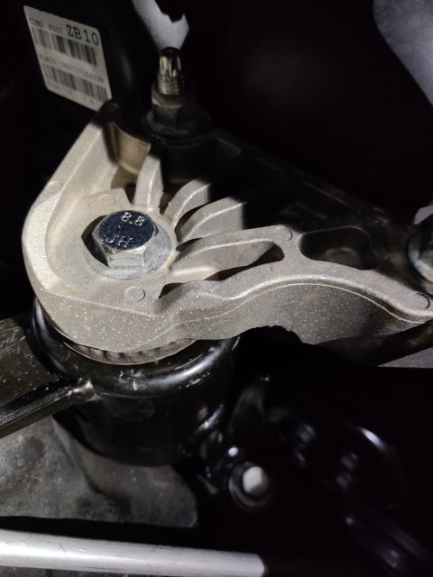

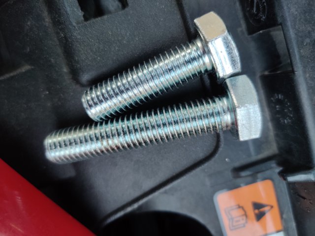

#40
So the 40 mm is the one that will work the other is to long 60mm once I slaved over getting the sheered one off it was a breeze. In case anyone one else has to do this m12x1.75 40mm . So I will drive it 😁normal with no spirited driving until my whoosh ARP bolt comes in. Man what a pain good looking out Ford.
