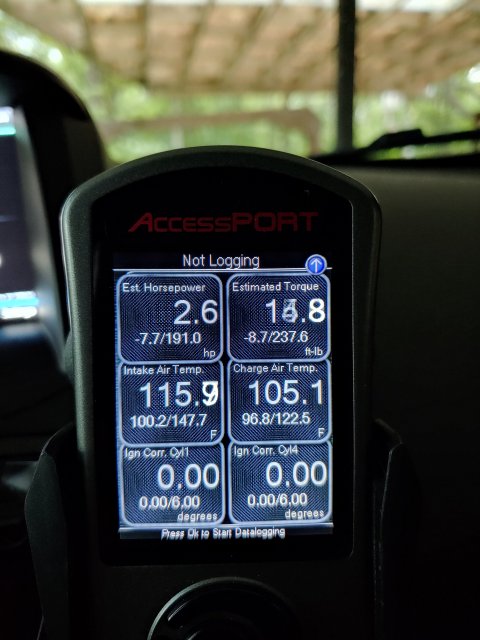

So i went for a drive to check numbers, had the tune installed for a full day now and maybe done 60 miles or so joyriding. I wanted to see what the AP said my power numbers were as i didn't have them on yesterday, curious how accurate these are supposed to be. It was between 92 and 94 degrees for the drive so not the best for power.
I also wanted to ask about corrections on the display. It always shows 0.00 for cyl 1 and 4 but below there are smaller numbers, which represent the number of corrections? Here's a photo of the display when i was parked at home at the end of the drive. Also as is shown, is a peak intake temp of 147 high for this ambient temp? Charge was peaked at 122, i assume both of these were at stop lights after the engine was fully warm and so they were getting more engine bay air. While driving intake temp was usually 10 or 15 over ambient.
Hypergram
1,329
901
Orlando, FL, USA
The smaller numbers at the bottom are the highs and lows of that particular stat. So my boost pressure might say -11/20 psi. For the cylinders, positive numbers are good. Negative are bad. When stopped, it will say 0.00, but when moving it might fluctuate. I can see that it has on yours since it says 6.00 as the max. Not sure about your intake temps, but your charge air temps are what matter so I wouldn't worry about the intake temps unless they are stupidly high. Also, I have no clue how accurate the hp and torque numbers are. Some say they're good, some not so much. They only way is to dyno and compare I guess.
Heya Hyper. So i noticed that 6.00 too but is that the positive side? Meaning anything in the negative side is on the left, and the positive on the right? Also i was assuming about the charge temps but i should ask to be sure, charge temps are the air going into or coming from the turbo? And if they stay relatively low that means the FMIC is doing it's job right?
If im correct here it would explain why that number is higher standing still as there's no air to cool the FMIC.
You are correct. As long as the number is not negative, you should be good. Intake temps are going into the turbo. Charge temps are coming from the intercooler into the engine. It is the last step for the air before it is used for combustion; yes, if they are low your IC is doing its job right. Yeah, since you are stationary your IC is working harder since the car isn't moving/no flowing air.
I appreciate the explanation. Would it be true that the bigger FMIC also increases turbo lag slightly, since more volume must be pressurized before it gets to the block?
