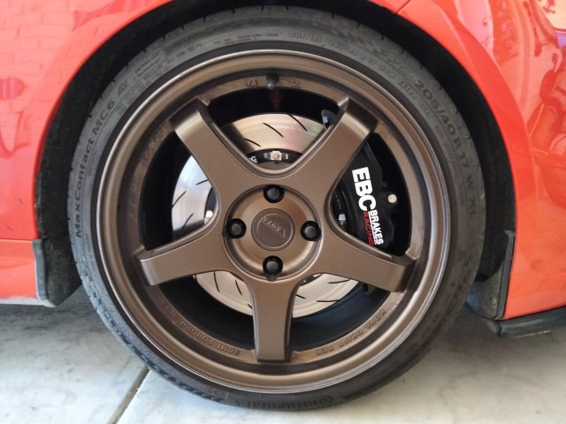

Hi There, I'm running the following Koya SF15 17 x 8” need +39 offset to clear (3mm) for EBC brake kit with 4 X 108 centers to suit a 2014 Fiesta ST. I'm in Australia, so that might not help. But EBC have the CAD drawings that I gave to Koya who helped me figure this out. Fitted the EBC kit just recently and fitted great. Stopping power is amazing.
Nice! Yeah the stopping power is unbelievable. It took me a while to get used to how much actually. I had to test them little by little because my brain had to recalibrate to the extra power. I kept stopping way too soon. haha
