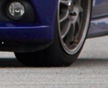

Can confirm, an enthusiastic autocross season on stock alignment completely destroys outside shoulders (especially on front tires). If you have a chance, see if you can get someone to take a photo of your car in the middle of an aggressive turn and take a look what the tire is doing.
Thats why symmetric tires like RE71r are nice since you can flip them inside out, effectively doubling the life span (maybe you can do the same with asymmetric tires, but I haven't tried). Increasing pressures help a bit but then at some point you start losing the traction.
EDIT: Here's 205/50r16 at about 45psi. This tire set did much better than stocks, but even here, you can tell the shoulder area is going to get it especially if you're peeling out of the corner.
