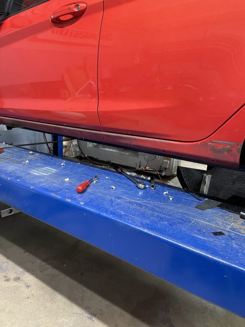

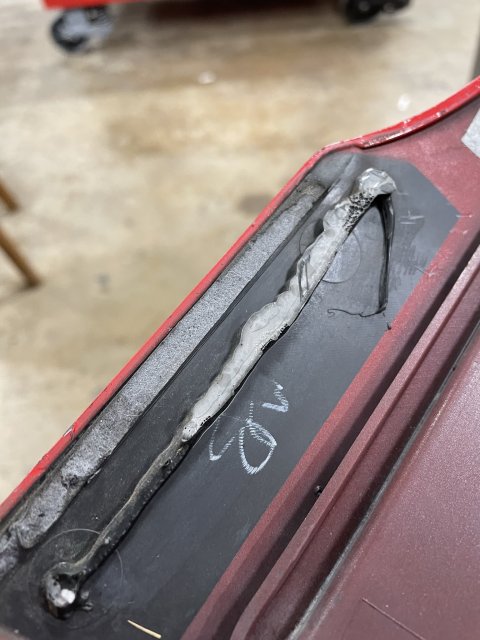

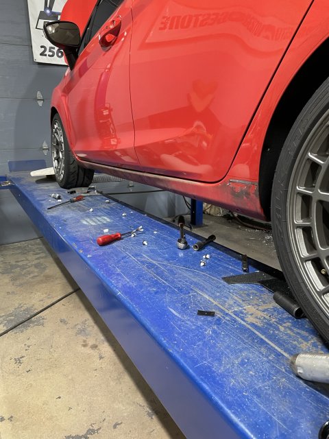

Mine has foam tape at the top but below that there is a line of a hard adhesive. The rockers do no appear to have ever been replaced. I owned the car since 2019 with 18K miles.

I believe it is a 3M OEM 2 part adhesive like this;
Or their 8115 version, except that one dries black, and the adhesive residue strip on my rocker panel from the side skirts was that clear/amber/gold color when I removed them. [dunno]

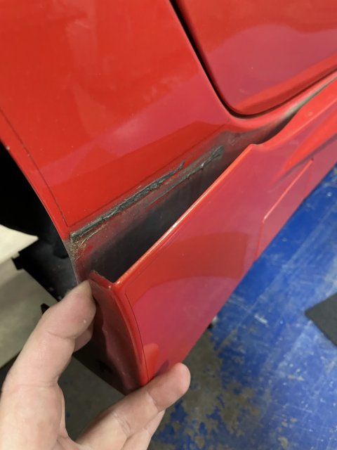

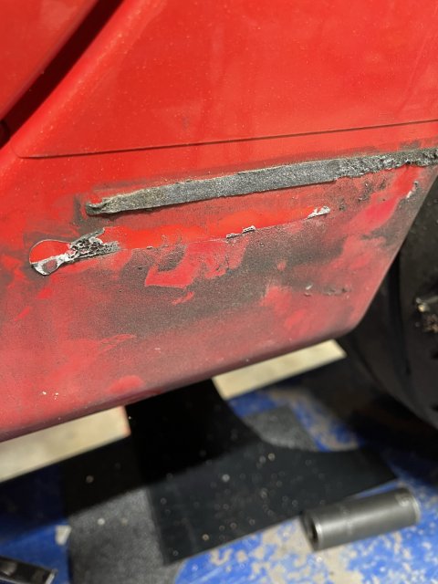

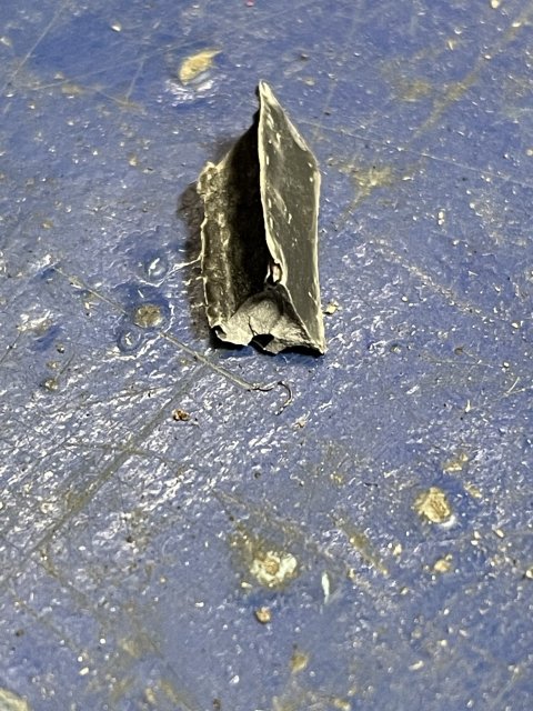

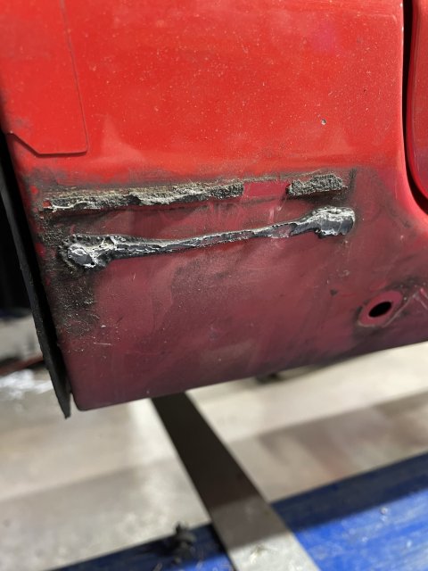

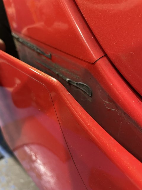

Here are some pics of what the "glue" looks like on the car and rocker.
Looks like Ford put a primer on the plastic panel before applying the glue. Its also not flexible at all, almost like a harder epoxy..
View attachment 57244 View attachment 57245 View attachment 57246 View attachment 57247 View attachment 57248

No answer for you unfortunately as I’ve been trying to figure out the same but confirming my car looks the same with foam + 2 lines of what I assumed was some form of epoxy

That does look like old, dried up 3M 8115 two part epoxy adhesive.
Has that sill extension ever been off the car before this, or repaired by a previous owner/Ford under warranty/etc. that you know of (are you the original owner?)??
My epoxy residue might be that amber color because the extension was already replaced once under warranty, and the dealer body shop may have used a non-factory epoxy adhesive. [wink]

I bought the car at 18k miles with no indication of any major repairs. Since the other aide looks similar I would guess the rockers have never been separated from the body. I noticed on the passenger side the epoxy has let loose on the rear portion.

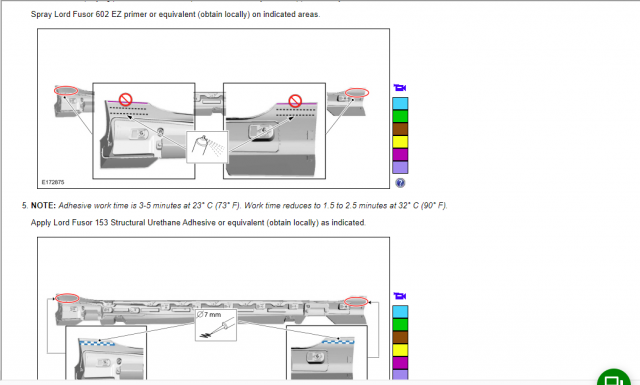

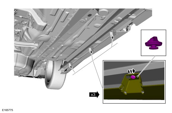

Oh that is different than what I found in my manual.
Thank You.
I will need to check on the primer for the 3m products before I do this.
This is pretty much what the Mustang Ranch version of the service manuals covers for installation.
