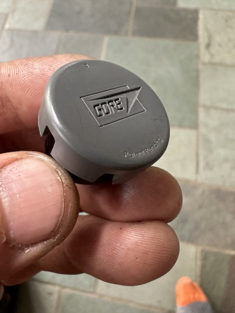

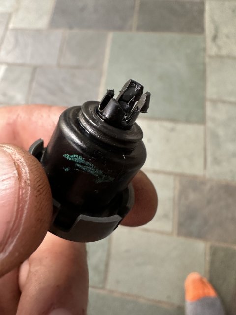

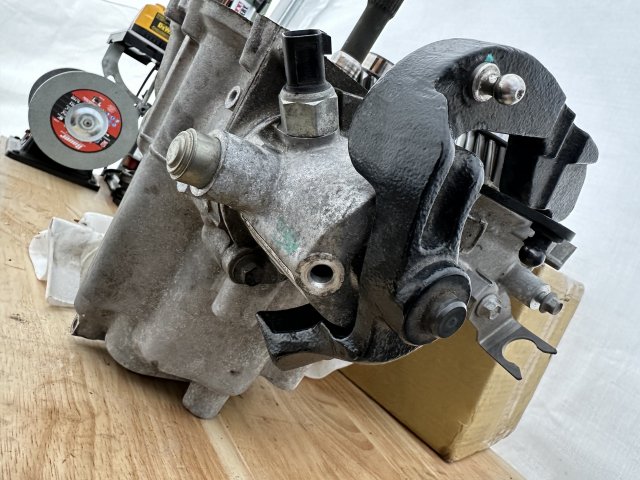

So I have my transmission apart and I grazed my hand along this piece in picture 1 idk what it’s called and it felt loose. So I decided to take it off and I noticed it was missing part of two plastic prongs that hold it into the piece in picture number three. So I then looked in the hole it goes in and saw the broken piece. I tried to grab it with tweezers and it took off. I can’t seem to find it. Do I say screw it and put the transmission back together, fill it with fluid, drain it and hope I find it in the drain pan or start ripping everything out of the transmission. I really really don’t want to do option number two.

I think it's a breather/vent cap. If I were in your shoes, personally I'd replace the cap and not worry about where the piece went.
Edit: CV6Z-7L282-A
Thanks for the advice and part number. I’m gonna just run with it. Just having trouble finding that part in stock unfortunately.
