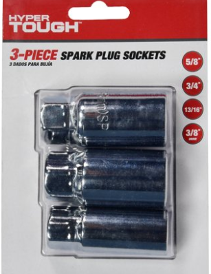

Cool. Maybe it's just me. But third one is stuck every time. Might not be the plug, it might be the tolerance in the 3rd plug channel. That's what I was talking about in terms of it being difficult. There are a bunch of threads on this. Some people seem to have no problem and can fit a regular spark plug socket in there no problem. Others like myself are not able to, it's like the tolerance is so tight that the socket won't fit or gets stuck. Do a search and you'll find a few threads. Good to know in advance in case you have issues. Otherwise spark plug change is a 10 minute job.
If the socket gets stuck then you don't know if you're tightening the plug or not. Also it's a PITA because you can't get a regular plug socket in there with the rubber grommet that will pull them out.
The picture below illustrates my solution. It's a 16mm or 5/8" socket. You can either (A) sand it down like the gold one to the left, which allows it to fit in the channel, or (B) fit the socket on the plug but don't put the extension all the way into the socket. This allows you to turn it without the socket getting stuck. Here's what I do:
1, use my gold socket to loosen them
2, use my pen magnet to pull them out
3, use my socket plug to drop them in
4, use my gold socket to tighten them to spec
I know all that is confusing, hope this is helpful.
