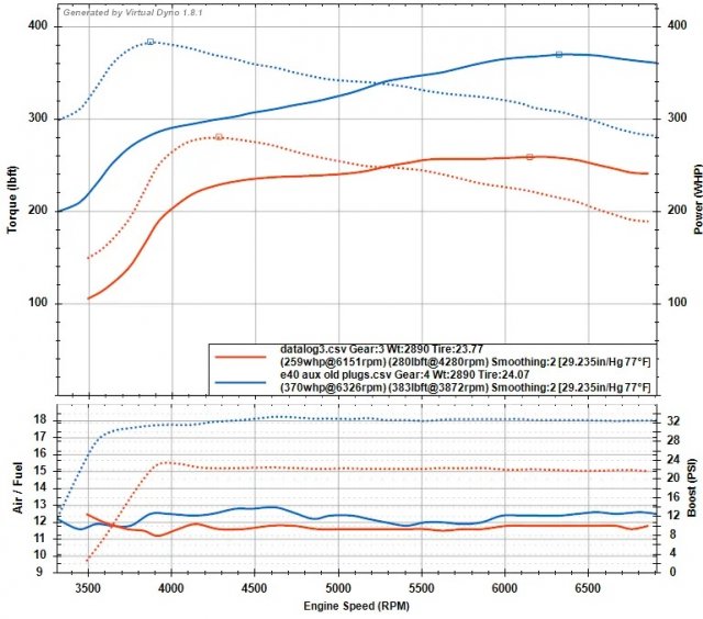

I think I'm similar, around 27-30 psi by 3600-3800ish RPM.
This is a really old screenshot of my 2nd revision of pump gas vs my finalized e40 tune. I "think" it was my finalized e40 tune, it's been ages so I don't remember anymore lol.

#31
Take a datalog of what you are running now and we can load it into Datazap, gives us another data point of upgraded manifold vs stock manifold.

I'm wondering if the lag is truly there or if the ceiling is that much higher so it is perceived as lag? More data gathering needed.
403
353
Salem, OR, USA
#40
Honestly I'd bet that even in that 2800-3500 RPM "wait period" for the full spool, that you probably still make more power than a stock turbo in the same RPM, but we'd need dyno comparisons to be sure about that.
