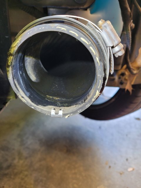

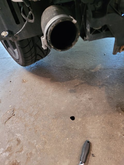

Another oily intercooler.

A catch can in a pressurized compressor line, and at the lowest point in the system?
(or on a bend where it would be thrown into it)
Is the oil from the crankcase/valvecover or from the turbo or both?
If it's from the turbo, is it typical for the seals to leak that much oil?
Seems like that would be an issue with the seals in the turbo?
Changes from stock?

Of course no one is going to install a catch can in the actual charge hose line/path, and that oil Ironmonger is seeing has to be from the turbo oil seals.
But the OCCs do cut down on the oil mist getting into the combustion chambers from the recirculation of them into the intake manifold from the factory PCV system.
Why have BOTH whatever oil mist/vapor the factory system is dumping back into the intake manifold, in tandem with whatever is getting into the intake tract from the turbo oil seals dumping it into the charge pipes/hoses, all going into the chambers, and therefore onto the intake valves??

I believe oil is coming from throttlebody side as it had substantially more residue than the turbo side. I haven't noticed any oil loss or burning on startup/ warm up so hopefully not a turbo seal. Once my rmm gets delivered I will investigate further upon installation.

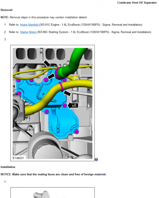

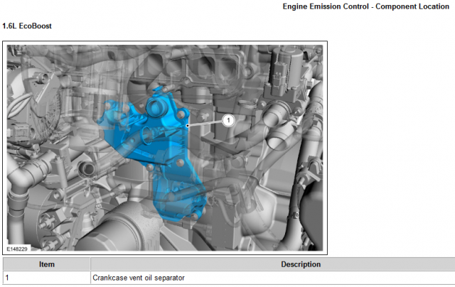

Well, the fact that there's a procedure, suggests that this is an expected condition?
The oil separator appears to be right above the oil filter...
If you can determine where its line(s) tap into the intake, you may be able to determine whether it's the source of the oil.
