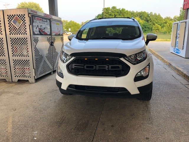

I did 5w30 for one oil change. All I noticed was about 1 mpg less, overall. I'm back on the 5w20 and mileage is same as new again.
If I lived in Tucson, I'd do the 5w30, but I don't even drive it much in the winter. I have the Winter Package EcoSport for that.
I really like it.
