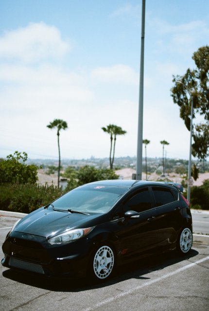

Also, here's a flic of the shitbox post disagreement
