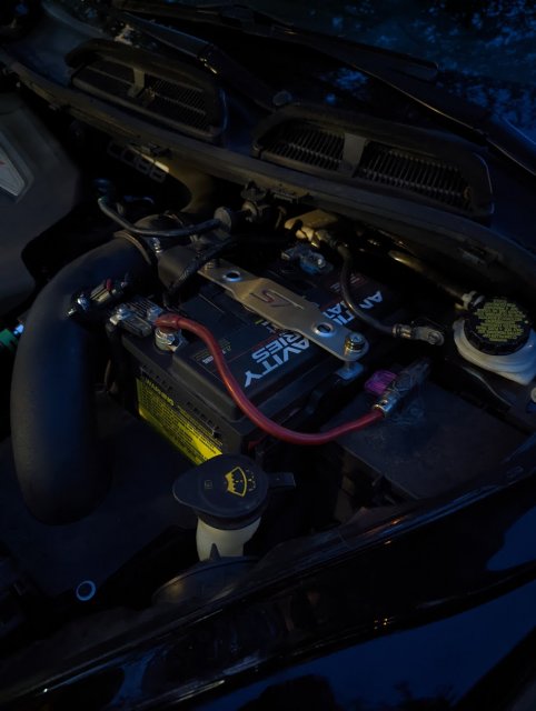

Sorry to bump up such an old thread, but I just wanted to say thanks for making the post.
My ST's battery gave up the ghost, and I'm in the process of parting out my RS which just so happens to have a Group 48 Antigravity Battery I bought a year ago.
Bit of trimming on the battery tray, and some couplers and bolts on the tiedown to accommodate the taller battery, and a 12 pound battery is in.
Super tight fit, will monitor it to make sure no problems arise. Did perform a BMS reset as well. Glad I might get to keep this battery.

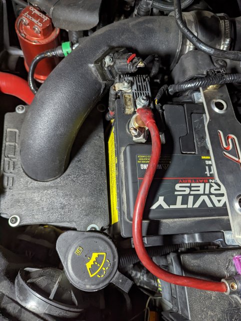

Fits like a Glove....mine has been rolling just fine and dandy. Like I said....just trim the front lip of the tray....get some bolt extenders for the battery hold down strap and wham....home free. Plus ....my 48 series was like $25 & TX @ my old werk Autozone. Nice to see another member figured it out.
That was a steal!
