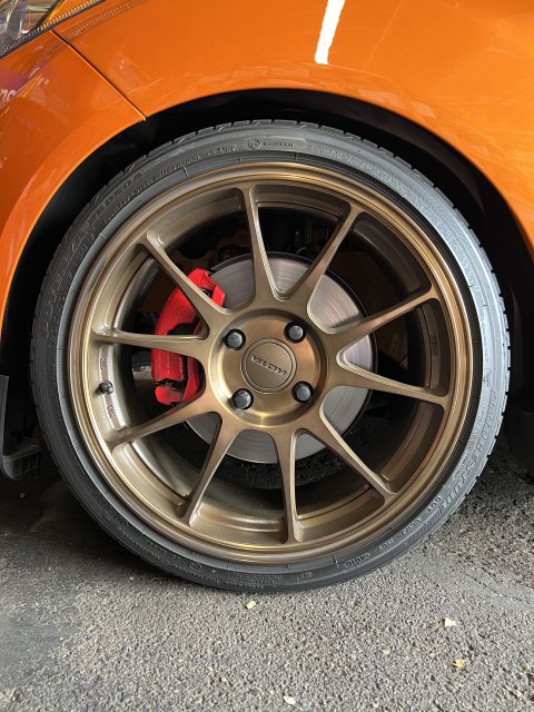

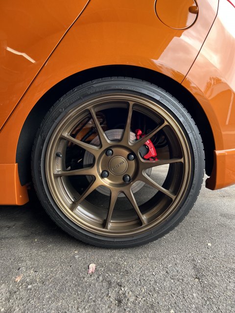

are those stock size tires? The wheel gap does seem a bit larger than my swifts with stock shocks. I am also not liking the ride and performance with the stock shocks and from peoples reviews the Bilsteins are great but many report they raise the car.
so to the OP, Im a bit in your boat also. Koni yellows seem like they’d be a good option for performance but at almost $850 for a set your almost into some coil over territory.

Here mine as it sits now. Funny the pics seem to make it look like the gap is bigger than when I’m standing here looking at it in person.
Again: swift springs, stock shocks and OEM tires on 17x7.5 wheels
