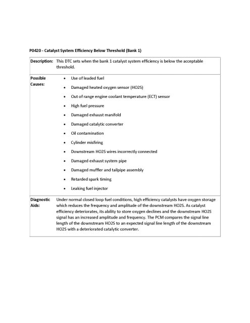

Here also is the info from the service manual.
I hope it helps.

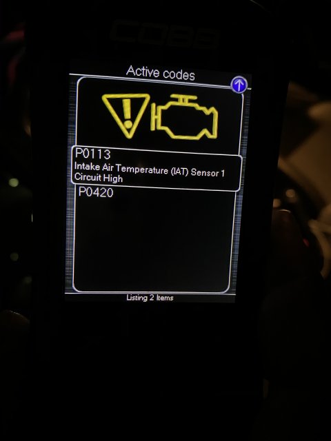

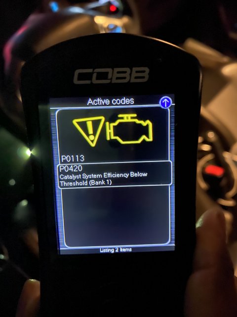

So, We hooked up my friends accessport to check and clear the codes... attached Is what we read.
the code has not came back on since clearing but we will see in the next few days of driving.

Thread Starter #27
P0420 code is back on! :(
option one, replace the second sensor next to the downpipe?
option two.. bring the car into the dealer and hope it’s the cat needing replacement?
3yrs old and just under 50k, this makes me sad.
