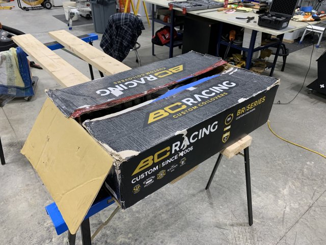

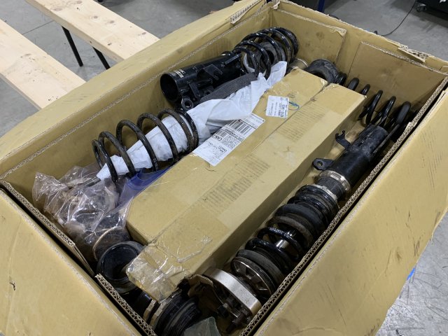

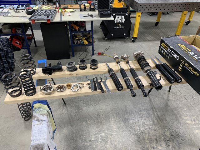

Interesting developments in my suspension experiments. I managed to get a used set of BC Racing coil overs for $350CAD (255 USD) on a Fiesta ST group on facebook.
The person selling them hit a monster pothole and the front right damper gave out. He ordered two new front replacement dampers to replace them, but failed to disassemble them fully. He did not have impact tools and some rings were stuck in place.
Big package and quite heavy.
The two boxes in the center are the new replacement dampers.
Here is a full inventory of parts.

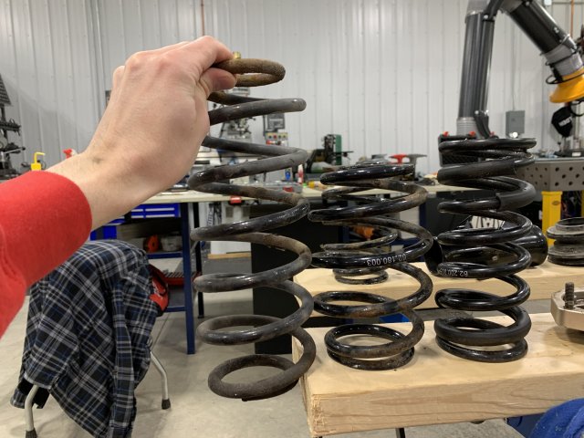

Difference in height between OEM springs (left) and BC Racing 3k rear springs (right). Rightmost is a front 5k spring.

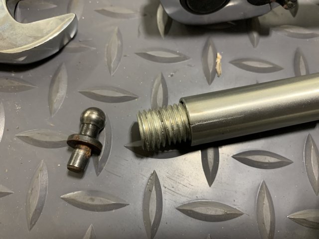

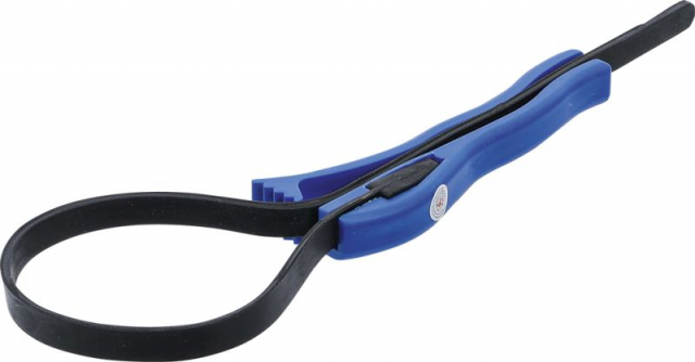

Does anyone have experience with unfreezing stuck rings on these coil over threaded bodies? I managed to get a couple of ones off, but the remaining are the two rear dampers and one ring for the front damper.
I could buy new rings for the front, but I need a solution for the rear rings. I tried a bunch of penetrating oil as well as heating up the rings to no avail. I'm starting to chew up the rings themselves. I've seen online videos and posts about soaking the shock bodies in ATF, that will probably be my next step.
It's an inherently difficult part to clamp or affix to a bench... Circular body with threads you don't want to damage + slim rings with limited angles.
247
194
none
#25
Leather/rubber straps to clamp it down and a hammer and chisel/flathead screwdriver to knock the rings loose.
Tools of this nature does exist, but can be jerry rigged with rubber/leather strap in a vice.
I actually broke a tool just like this at the handle. I'll have to buy a sturdier one.
I've seen recommendations for an air chisel. Knocks the rings loose, but not sure if you can reuse them after.
An air chisel might wreck some of the outer threads. Especially if they're a soft metal, but might be worth a try.
Else if it's corrosion creating the issue you might try to soak it in some mild acid. This is a reference to cookware in aluminium, but there could be a trick or two to try out.
https://schaumburgspecialties.com/how-to-remove-oxidation-from-aluminum-stepbystep-instructions/

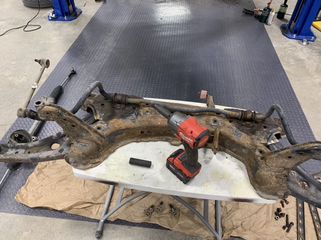

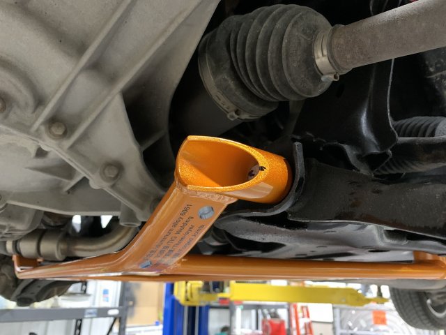

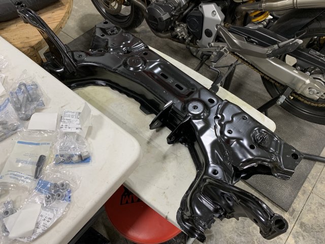

Some might have seen this in the daily thread already, but I completely replaced the sub-frame. Here is a more detailed description of it.

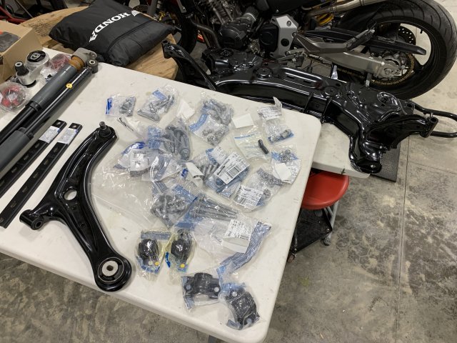

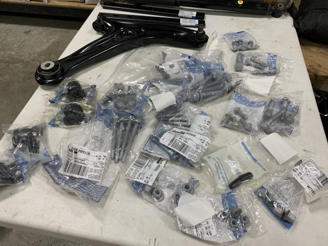

Starting off with a lot of hardware. I actually ordered spares for almost all bolts, just in case.
You can also see that I got new braces and a control arm.
Subframe was shipped as is, no box. I carefully removed all the shipping stickers.

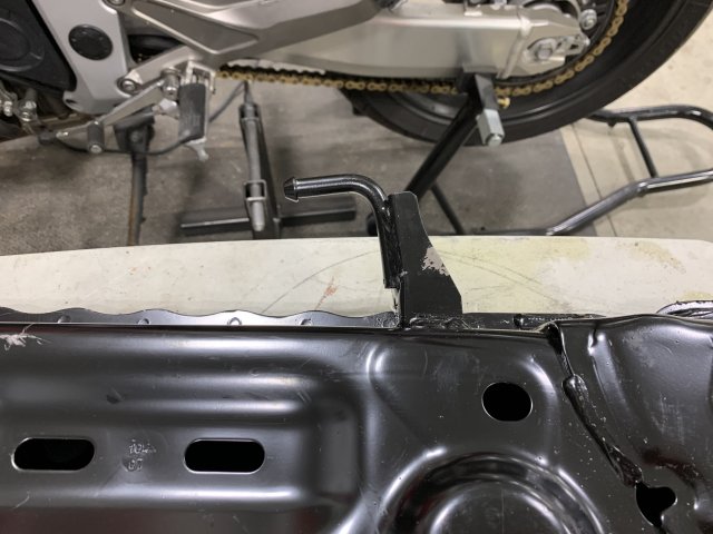

Unfortunately, the did bend this piece (you can see where the paint flaked...)
Another view of the extra hardware.

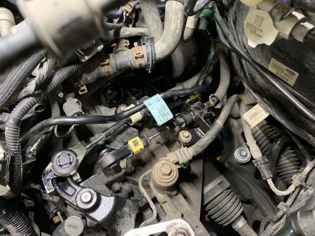

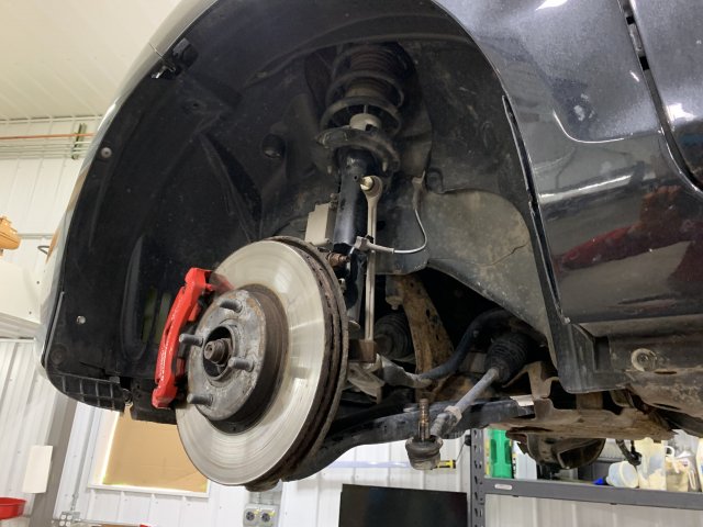

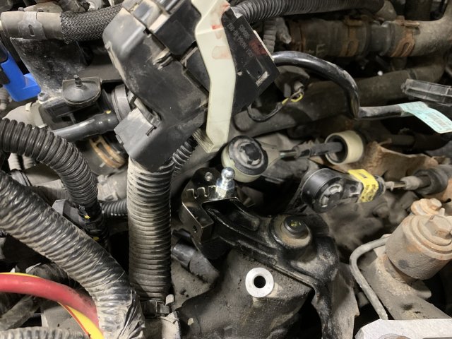

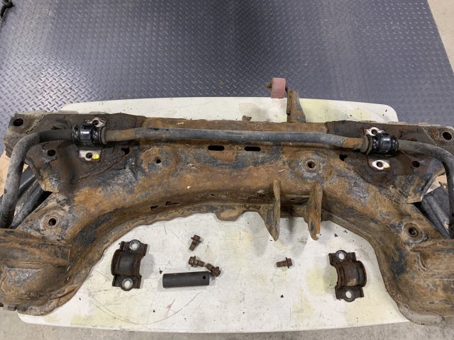

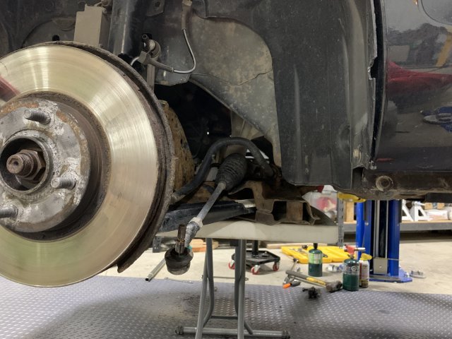

Starting off with undoing the sway-bar endlinks, tie-rod end and the lower control arm nut at the knuckle. I had immense trouble removing the passenger tie-rod. I have to heat-shock the tie-rod 2-3 times with a torch and PB blaster.
If you needed a reminder of why it needed to be replaced. If you have a keen eye, the exhaust hanger has rusted off.

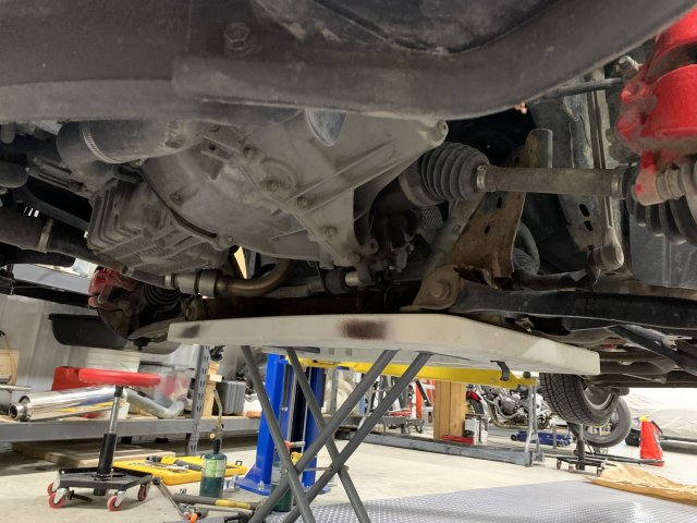

Placed a table underneath the subframe, lowered the lift a couple of inches above it and started to impact out the bolts carefully.
Another view of the underside.
Full thing out.

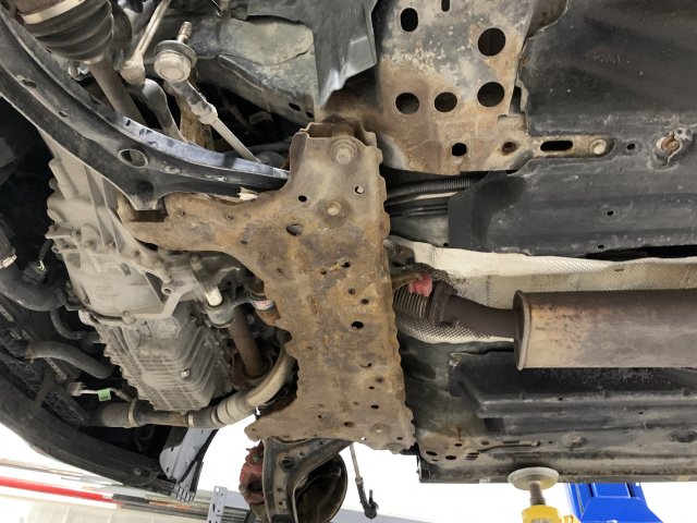

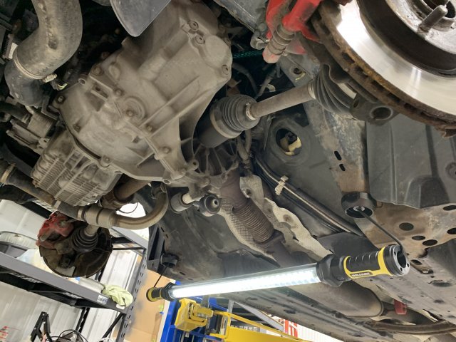

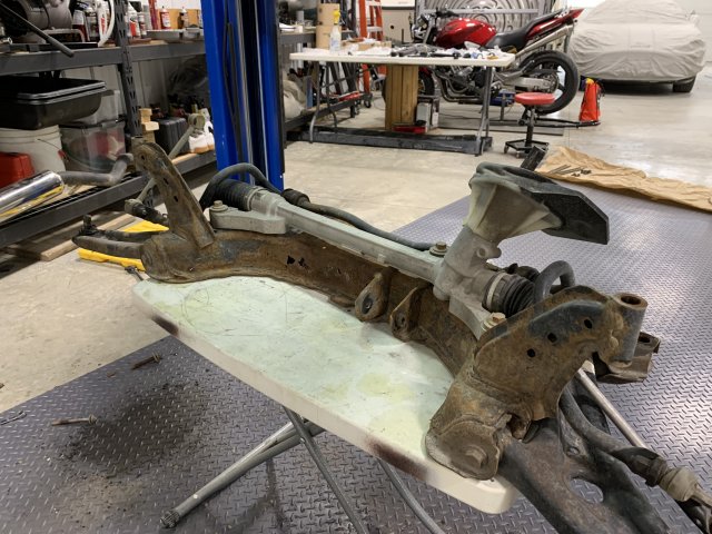

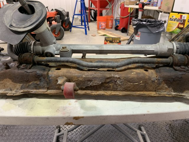

Underneath, without the subframe. I was quite surprised at the condition of the underside. Apart from some surface rust, this is still solid. Mind you, I never rust treated the underside of this car (major mistake in hindsight, but very time-consuming).
Big rust holes.
Flaking off. You can imagine the loss of rigidity this caused in the car.

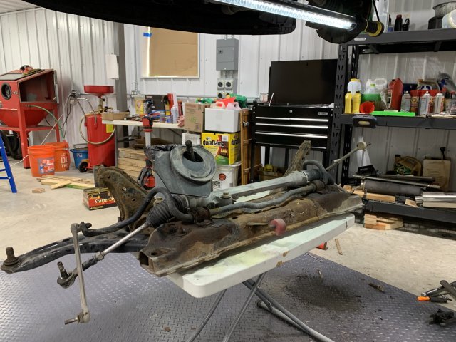

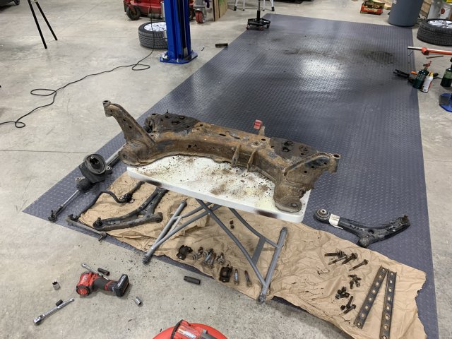

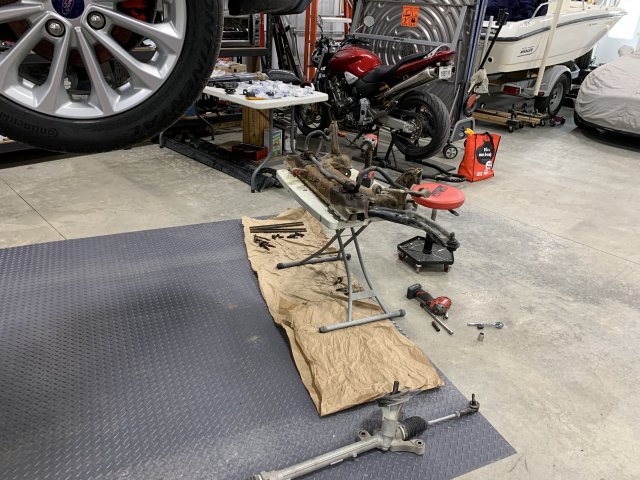

Set up a little station and started to undo the steering rack.
Impact drivers for rusted parts are KEY. Well worth it, just make sure to hold it with two hands.
For reference for others. The yellow dot is placed towards the front.
Everything out.

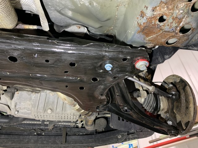

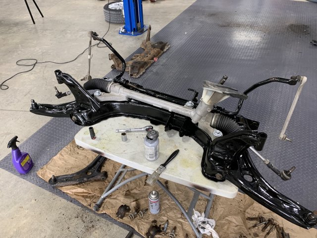

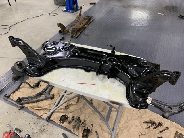

New subframe on the table, ready for reassembly.

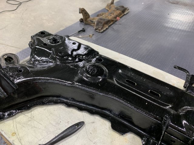

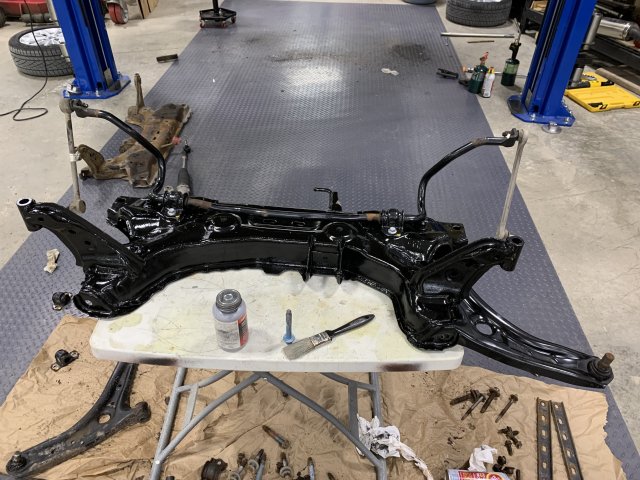

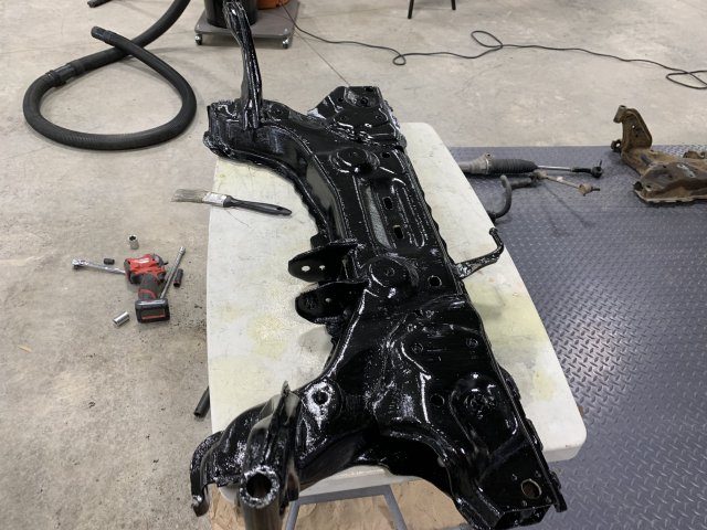

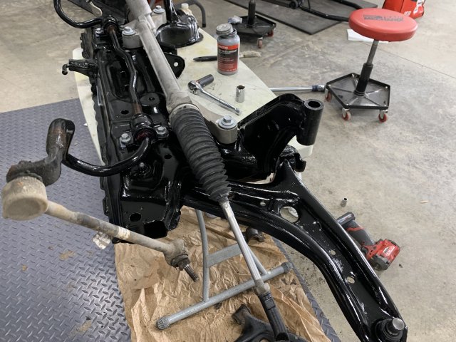

First order of business is coating the entire thing in Fluid Film. I then brushed it over with a paintbrush to even out a coat in every crevice.
You can see the paint brush strokes.

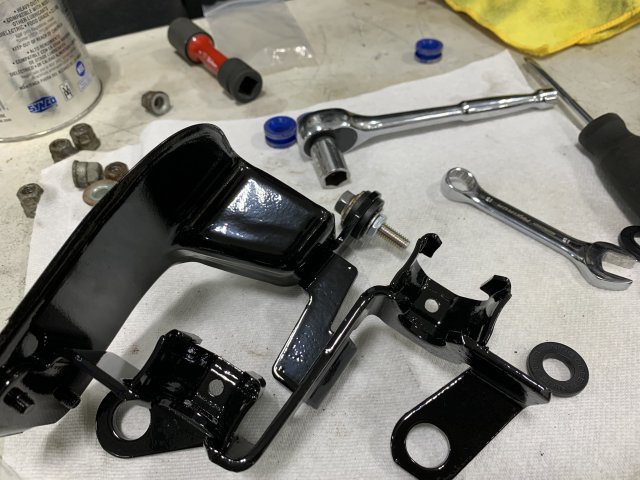

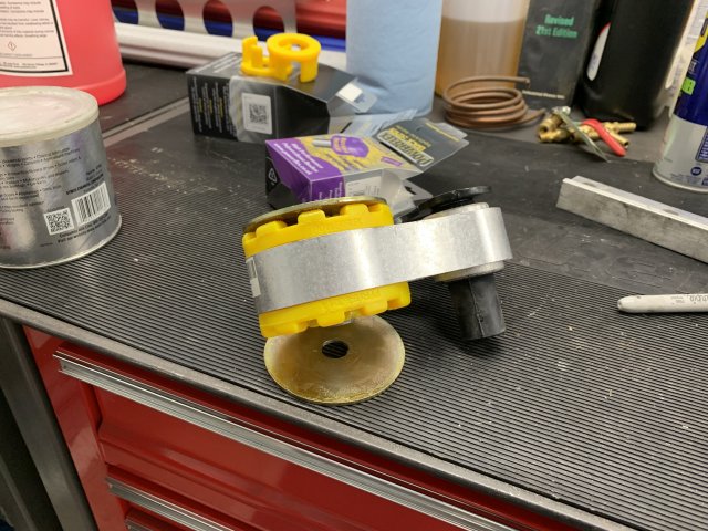

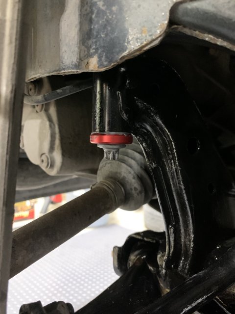

New sway bar bushings, bolts, and brackets. I cleaned the swaybar itself, but did not de-rust it.

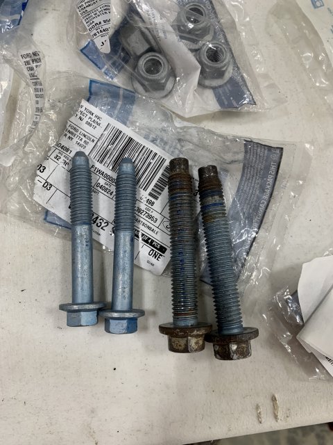

Faced my first setback. The bolts in the ford diagram are wrong. The right part number for the front lower control arm bolts is (W715977-S900). I re-used the old ones (they are torque to yield, so I will be replacing them when I install the swave brace).

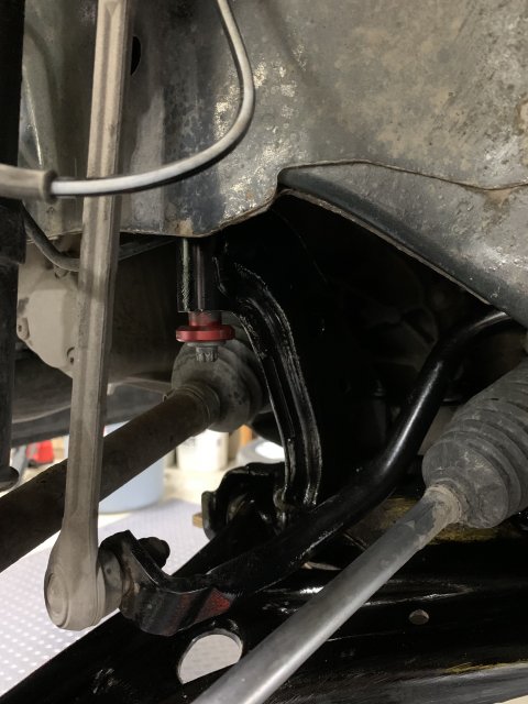

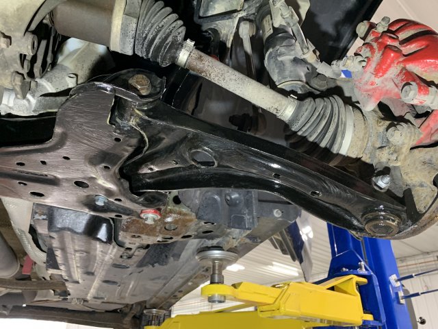

I cleaned the old control arm and coated with fluid film. Did the same for the new control arm, minus the cleaning. Installed the rack with new bolts. Placed anti-seize on some bolts, mainly the ones that required the impact driver when I removed the old subframe.
You can see in this shot, the swaybar endlink that the alignment shop replaced 6 months ago. It's super heavy, stiff and hits the inside of the wheel well. Not recommended. Since this picture, I received the OEM part and installed it.

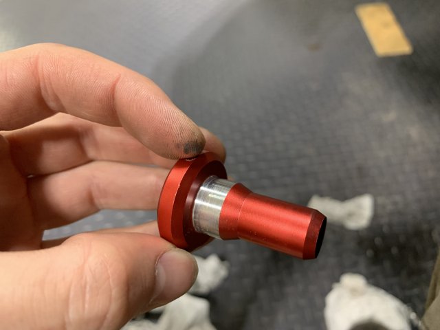

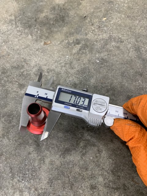

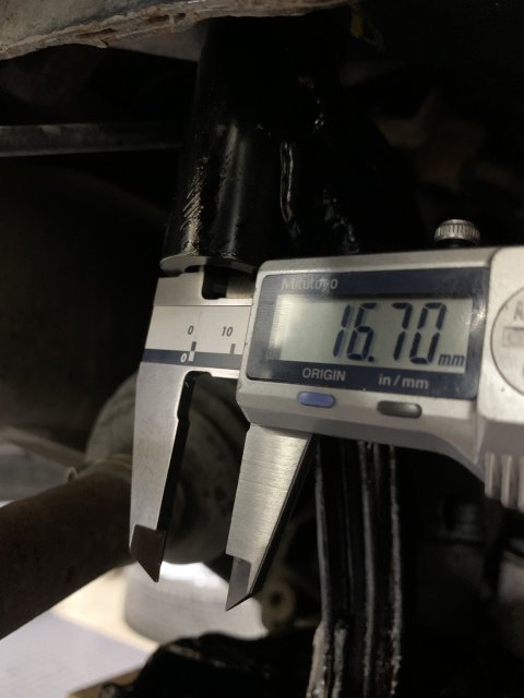

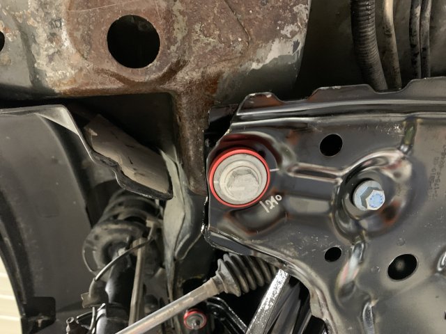

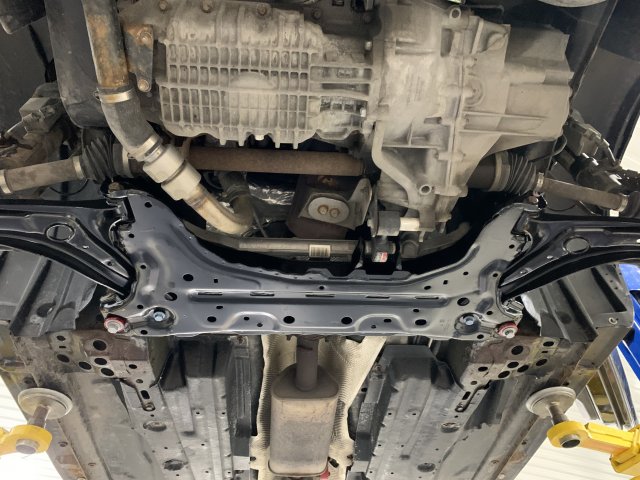

Second hiccup with installing the subframe. The whoosh subframe centering spacers on the upper bolt had a slightly too big of an OD and could not fully fit inside.
Lower spacer fit fine however.

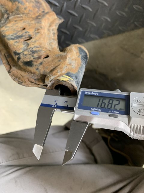

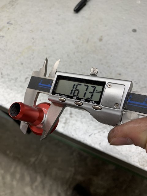

OD measurement.
ID measurement of the new subframe.
ID measurement of the old subframe.

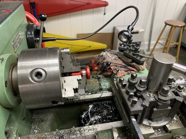

Actually exchanged a couple of emails with Ron. He recommended scrapping off the paint inside of the tube of the new subframe. I would rather not do that (because of rust concerns).
So I just chucked it on the lathe.
Did not take long, removed just a bit more than the anodization.
Measurement after machining for reference.
Success! With liberal amounts of anti-seize.

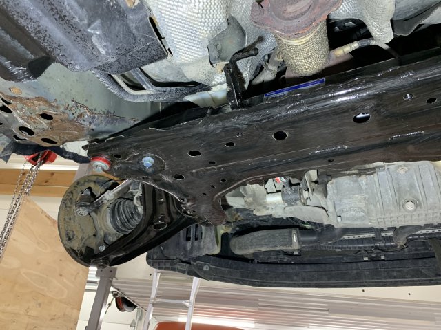

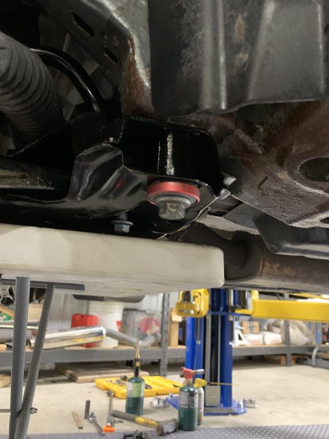

We are in. Now it's time for the insane torque to yield bolts. Let me get my 10-foot cheater bar.
I torqued to the first torque spec and used a silver sharpie to mark down the 240deg angle, so I could make my life easier. I was alone, so I had to check frequently. You can see I marked the 180 deg + the 240 deg mark.
Once I torqued everything to spec, I lathered the underside with Fluid-Film.
I since plugged the holes in the subframe with rubber blank grommets.
Even the lower control arms.
Did I feel the difference? Absolutely yes. It was a night and day difference. Tracks straighter, less torque steer. Happy I did this, but it was expensive. This is the downside of having a performance version of the car that is based on an economy platform. You might say that this is only because it has seen 10 winters, but it's true regardless.

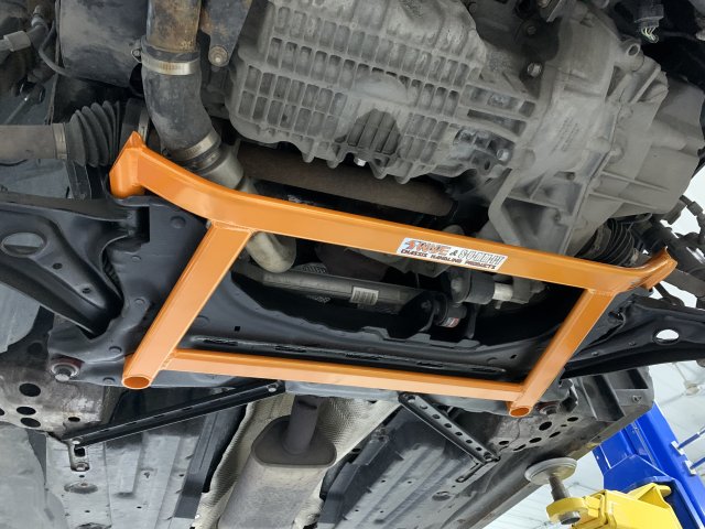

Overall, I am very happy with the result. Pretty stoked to add the swave brace soon.

WOW, that subframe was literally crumbling! [crazyeye]
I would have dipped everything in a huge vat of POR-15, and painted all of the other unibody rust with it as well (after stripping off all of the rust).

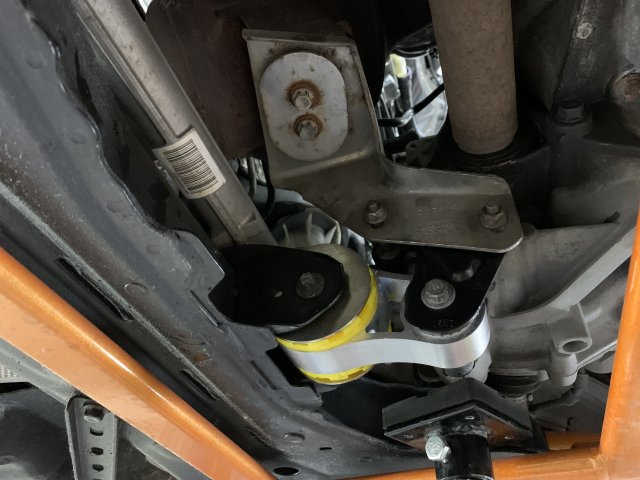

If you were so inclined to install the stiffer aftermarket rack bushings, the pre-loaded SuperPro control arms, and/or bigger front sway bar with stiffer poly bushings this would've been the time to do it. [wink]

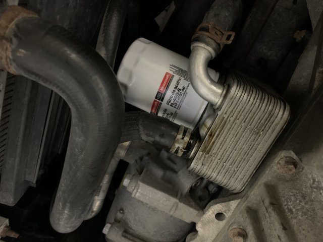

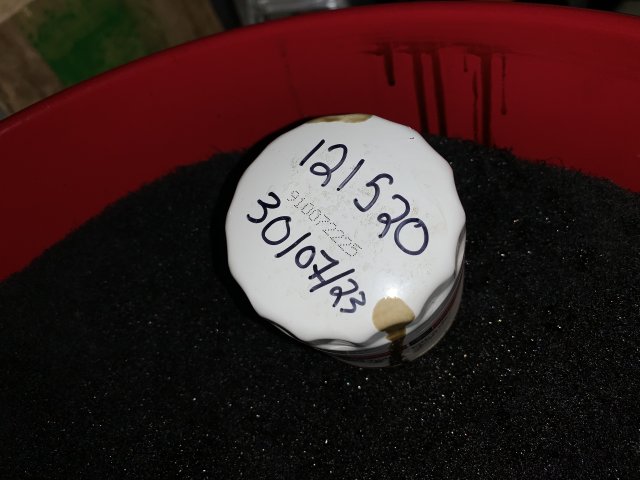

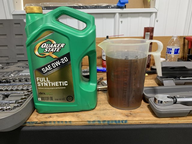

I usually change my oil two times a year, regardless of mileage. However, this spring, I completely forgot. So I finally got around to it. It is my longest oil change interval yet! (14 368 km). For this reason, I sampled some oil to send off to Blackstone Laboratories.

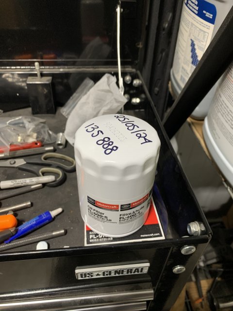

It was my first time trying the FL-400S filter.
Here is the mileage of the old filter. July 2023, yikes!

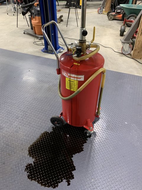

Had a small spill. Turns out it was completely full. Nothing beats cleaning spilled oil on the ground on all fours.

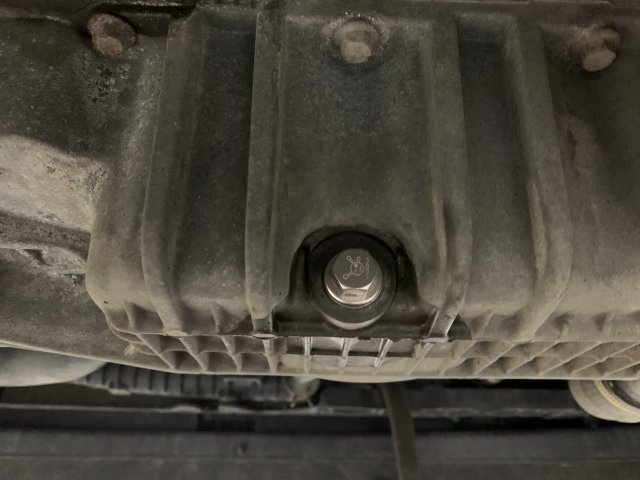

I have a magnetic plug. Had a couple of metal flakes on it.
Here comes the controversial part (the oil choice). For my use-case, I chose Quaker State 0W20 because it was highly rated on the 540 RAT blog. We usually have 3 - 4 days per winter where the temperature is below -20c. I wanted to make sure that with the 0w20 oil, I was preventing cold startup wear as much as possible.
I had a previous oil analysis from Blackstone on this very oil that was excellent from their perspective. (Attached below)
I always measure the exact quantity I put in, this is maybe OCD, but it certainly makes things easier.
Last step was fitting the oil filter back on. I put 200mL into the filter and another 4300mL in the engine, for a total of 4500mL. This is around 200mL more than with the FL-910S OEM filter. Dipstick shows middle level.

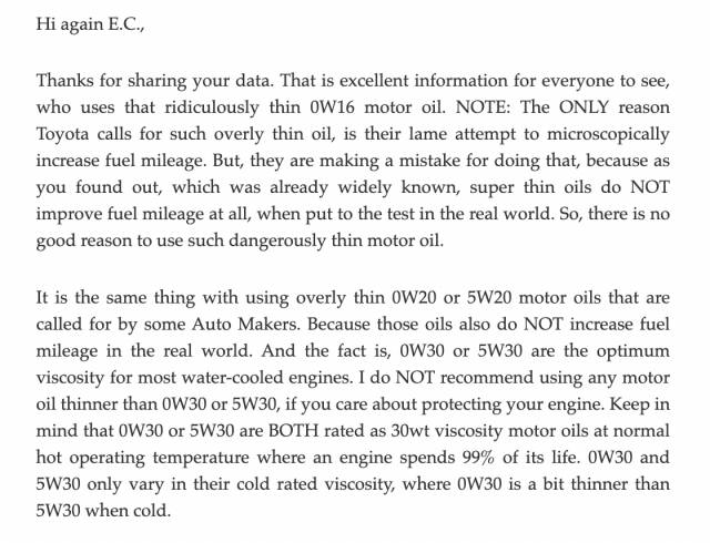

It's been a couple of years since I read the 540 RAT blog, it's even longer than I remember, with much more info than just oil. From my memory, he has really galvanized his position on Xw30 oil (0w30, 5w30, etc.). He argues that anything under 0w30 & 5w30 is too thin.
Here is the exact screenshot.
It's always interesting to read about oil because I feel there are direct comparisons to the Hi-Fi community (science-based approach VS established dogma VS urban legends VS brand allegiance VS internet folklore).
The larger filter was a bit more difficult to install, but still ok. I wonder if a thicker aftermarket radiator would make things a bit more difficult.

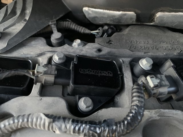

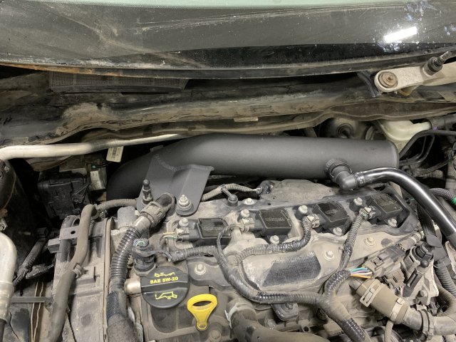

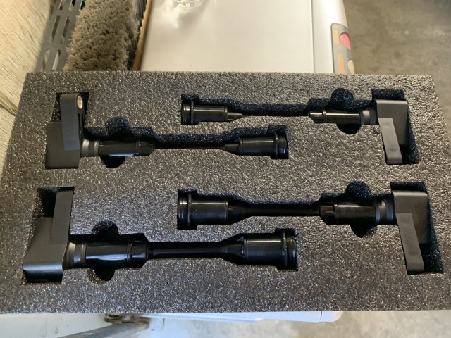

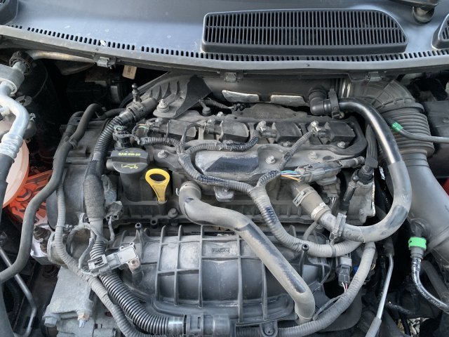

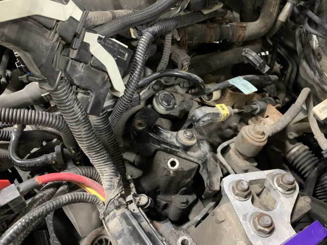

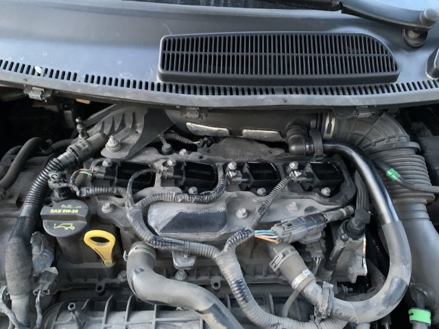

I also installed the Whoosh coils. Reviews mention a smoother idle. It's difficult to tell whether it's placebo or not, but perhaps it is actually smoother.
New and clean
Had original coils from 2014 @ 135K kms of life.

As a side note, any tips on cleaning the engine itself without the cover installed? I usually foam the interior with a pressure washer foam canon and then agitate with a small brush all the areas. I then rinse away with a hose on the shower setting. Would this still be advisable with the cover removed? There are many more electrical connections directly accessible than without the cover.

Big post incoming! I'm behind on this build thread as I've been working quite a lot on the car. This was done exactly one month ago. I'll post the 1-month update on this at the bottom.

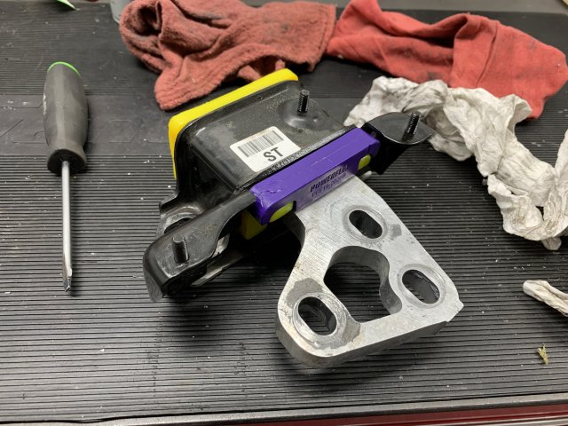

I have the Vibratechnics RMM with new OEM mounts, and I'm getting these intense vibrations coming out of idle that were highly unpleasant. I've been reading everywhere that it's the best mount with the least vibrations, but let me tell you, it was not the case for me. It made driving my car (that I love) a chore.
I've been wanting to address a few things, so I set up a big <<while I'm in there situation>>, let's get it all over with.
I'm installing :
- Pierce strut bar (dash rattles)
- Full powerflex bushing inserts (RMM, engine & trans)
- Mountine quickshift
- Cobb shifter bushings (Delrin instead of solid alu)

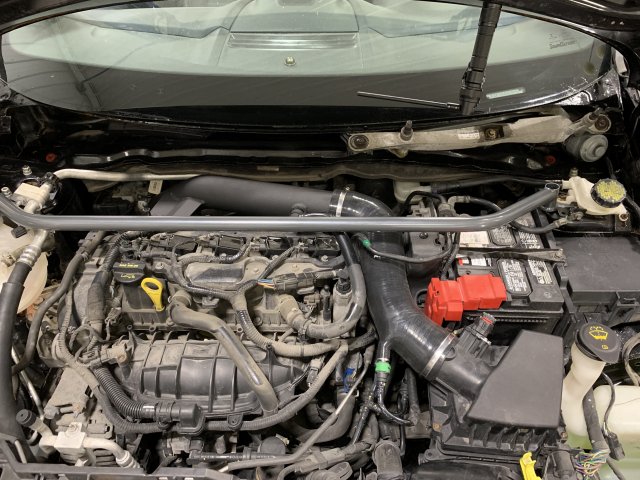

- Ramair crossover pipe
- Ramair S Pipe
Here is an executive summary, because I have 68 photos of this.
Everything needed to be removed.

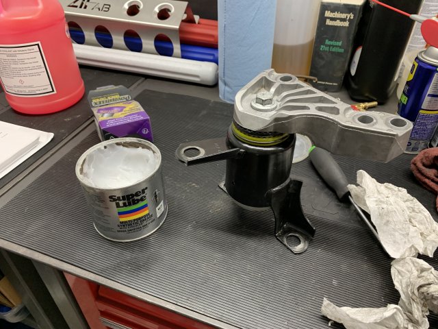

Removed my recently installed PSMM and installed the bushing.
Same for the transmission side mount.
Pressed out the OEM RMM that I had purchased, but did not install. I fiddled around to find good parts to equally press this out. I wanted to keep the OEM bushing intact, just in case.
Bushings in. Got to say, the powerflex stuff is high quality. As you can see, I did not put the inserts in.
Installed and torqued. No fuss. Sneak preview of the next post :eek:

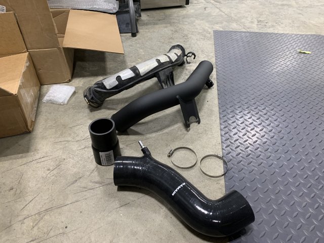

Ramair goodies from Whoosh. Build quality is nice on both parts.
Excellent fit.
Next up are the transmission related mods.

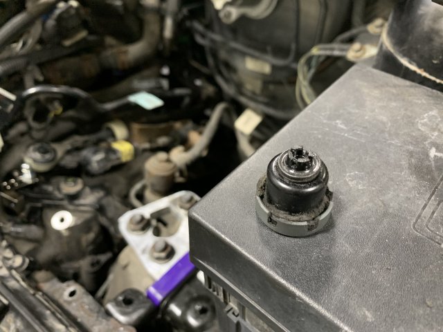

And I broke the breather vent, of course.
Ended up removing the rubber gasket on it and gluing it on the transmission casing with CA glue. I have the replacement on order.
Got the mountune quickshifter in. The left-most ball was extremely hard to get out, I felt like I was going to break things.
Broke the tool removing the ball pivot as well. Was being gentle and following instructions. This will probably stay on the car a long time.

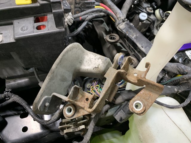

COBB shifter brackets.
Went from this crusty piece.
To this. Sandblasted, acid etched and four coats of rust-oleum professional enamel.
Bracket back in and installed.

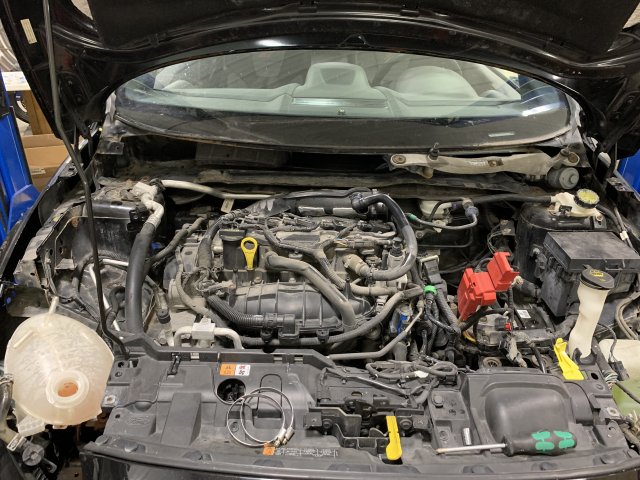

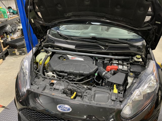

Pierce bar in. Installed new strut bolts as well.
Completed with everything back in. Not pictured is the time I took cleaning and Fluid-Filming the inside of the cowl area. Now protected!
Impressions one month in :
Piece strut bar : Good quality build, less stiff than I thought (holding it in my hands, but very light). Eliminated, I would say around 80% of the dash rattles. It's worth it just for that. Can't tell if it sharpens up steering, as I'm on 50 sidewall tires.
Powerflex buhsings : WOW! What a difference. It's almost like stock again, with the slightest vibrations at idle with the AC on. But oh man, no motor vibrations coming off idle like with the Vibratechnics. It's like driving butter. Absolutely wonderful. Only downside is a slightly elevated engine sound at highway speeds. Maybe 10-15% more?
Mountune quickshift + COBB bushings : Crisper feel, shorter throw. It took quite a while to get used to. Is it smoother? Maybe, it's still a tad notchy on some situations, but for me, it's not the night and day difference a lot of people are raving about. Worth it for me, as I bought it second hand never installed.
RAMAIR Crossover pipe + S-pipe : This is the only mod which I am mitigated on. The discourse here is that the crossover pipe gets mostly torque gains that were dyno proven. However, my butt dyno tells me otherwise. Rolling onto the throttle @ 3K in third feels different than before. It feels less torquey. I know my car, I've dailyed it stock for 10yrs. It feels like the torque surge I used to get comes in later, past 4K. I even added an ADAPT-X Tune with a tank full of 94oct, and it does not feel as potent as stock @ 3k, weird. It's definitely faster above 4k, but that's the tune. I'll go back to the Stage 0 v506 to see the difference.
I might re-install the OEM crossover pipe and see if I'm just imagining things.
What it does add, though, is sound. It's almost like a diesel turbo spooling up sound. Quite interesting, but I'm neutral on the pleasantness of the sound. It adds drama.
Overall, I'm very happy, especially with the strut bar and the powerflex bushings, wow!

I’m intrigued by what you’re saying about (upper?) strut bars and dash rattles. Originally I was not going to bother with one, but might need to reconsider
Regarding oil filters. I’m using the Amsoil equivalent of the FL400, with a Mountune radiator, it just barely clears threading it onto the nipple. At least the fan shroud is there to protect the radiator or it would be a nightmare. With no radiator upgrade, you might even be able to fit an FL-1A filter, which is another 0.5” longer than the FL400 (there are in fact at least four different length filters out there that use 3/4-16 thread and 2.75” gasket diameter)
Regarding oil viscosity, it’s a tricky topic. Having designed some fluid film bearings in the past, I can tell you that thinner oil *can* work on properly designed bearings and journals. The problem is that the clearances and manufacturing tolerances have to be much more tightly controlled, or there’s too much variability in the oil film strength at low RPM, especially as the oil heats up and thins out. Incidentally that’s the main reason that “lugging” an engine at low speed is bad, not anything to do with in-cylinder conditions.
Oil cooling and stable oil temperature becomes critical, which is part of why almost all cars now use sandwich coolers to keep the oil close to coolant temperatures as much as possible.
If you spend a crapload of money to get exactly matched clearances like they do in large steam turbines, you can use extremely lightweight oil to carry pretty hefty pressure loads on a proper bearing design.
Because of this, the converse is also true. Just cavalierly tossing heavy weight oil in one of these newer engines is *also* a recipe for disaster, especially on cold starts. Going a grade heavier to a 0W30 or 5W-30 you can get away with, but unlike older engines that were designed for 10W-30, you can’t just throw in a a 20W-50 weight oil, or even a 0W-50 oil and expect the bearing clearances to behave as expected unless you’ve rebuilt a motor with higher bearing clearances (0.001” over)
Where the new 0W-16 and 0W-20 oils get dicey is if there are any subtly out of spec or unmatched parts on the assembly line, or inadequately designed cooling systems, you’ve got dead engines on your hands.

Thanks for the detailed info on the oiling journal, clearances, etc. Good to know that if I ever upgrade to the Mountune, the AMSOIL filter clears it. Good to have a first-hand confirmation of this. I have received the oil report from Blackstone, it's attached below. Seems all positive, although I did not opt to test the additive package.
Let me expand on the upper strut bar from pierce :
We have rough roads here in Montreal and the car developed a lot of creaks over time. I'm sure the winter does not help this, especially all the heat cycling going on. It got to a point where the cabin was starting to get pretty noisy with creaking, some vibrations in the dash on bumps, some rattling sounds over expansion joints and even continued metal on metal sounds while on the highway.
I'm pretty sensitive to these things and began to really get on my nerves, especially combined with the Vibratechnics RMM, I was really unhappy.
After installing the bar, I would say that it reduced the sound of the buzzing, creaking by a solid 80%. Some noises are completely gone, others are attenuated greatly. Over bumps, the car seems to transfer impacts more to the suspension than before, resulting in less front end noise in general. Can't tell any handling improvements, but I can tell that the front-end is more rigid.
After installing the bar, I drove 600km to Toronto and I got a crack in the windshield. It was not impact related (to my knowledge) because the crack starts from under the cowl area and there are no impact marks from rocks or others. I noticed it after pulling out of a parking garage. It slowly spread across the windshield. It's now halfway there. I have the original glass from 2014 and so this might be expected?
Maybe I'm reading too much into it, but the added rigidity of the brace perhaps put more pressure in an already existing weak point in the glass (that I could not see). I got unlucky in the past year with three hit-and-run events on my car while it was parked. I have already done two insurance reclamations last year, I don't want my insurance to skyrocket, so I'll wait until the crack goes all the way across.

I installed the Swave 4 point brace about two months ago, just after the new subframe installation.
I have to say, the build quality is really nice. The paint has metallic flake in it, and what looks like clear coat over it.
This was before I changed over to the powerflex RMM bushings.
I used a sharpie to mark the final 180deg rotation torque rating.
Car is definitely tighter over bumps, more composed. Impacts feel like they are going through the suspension more than the chassis. Ground clearance is probably the best for an off-the shelf solution.

Yes, that item is THE lowest profile, functional front brace on the market, as I am not too sure just how much the very thin gauge flat steel, (but much flatter than even this Swave/Summit brace), DNA front brace thing is.
If I am never going to be putting my skid plate back on the car again to work on ARA rallies (which are now nonexistent within ~750 miles of me currently [:(] [mad]), this is the front brace I will install as well. [thumb]
