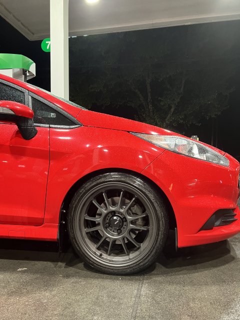

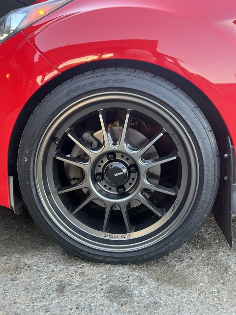

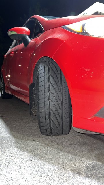

17x8 +40 offset 16.4 lbs 215/40/17 Nitto Neo Gens. 7.5 lbs lighter per corner. Cannot find details of how wide the tread width and section width is. Inflated width is 8.86 inches. 23.8 inch diameter. 280 treadwear.. A pretty wide tire for a 215, barely any stretch at all, could just about be called “squared”. Michelin PS4AS 205/40/17 23.5 diameter on stock wheels was my previous setup. Suspension is Bilstien shocks with Mountune spring. -1.6 of negative camber in the front. No official measurements but my guess with the combination of the shocks and springs it probably sits about 0.8 of an inch lower than stock. Slight rub in the front under big dips with steering angle if you’re really cooking it. About 2,000 miles driven on this setup in Northern California with condition ranging from 80s to mid 30s. Dry/Damp/wet/standing water.

Fitment wise, a good setup for someone on stock suspension or stock ride height. Unless you can stomach the occasional rub lowered. Pretty wide tire for 215s.
Good all around tire summer focused all season but not necessarily a stand out performer in any category. IMO from the experience I’ve gathered a slightly more capable tire the the PS4AS in summer dry and not cold conditions. Also tire and wheel sized to be accounted for.
