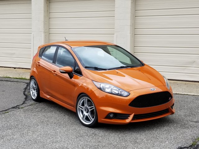

I chose to “downgrade” to all-season high performance 215/40 tires. They ride softer (taller sidewall) and turn in does suffer some compared to the factory 205/40 RE71s, but it’s not as big as an issue as you might believe.
I purchased Federal SS 595s which were grippy and long lasting. I currently am trying out some Nankang NS25 hi-performance all seasons. I haven’t taken them up to the canyons to compare them to stock RE71s or the Federals, but I am finding them plenty grippy.
These are the 205/40/17s RE71 on 17x7.5 wheels
215/40/17 Federal SS595s on 17x7.5 wheels
