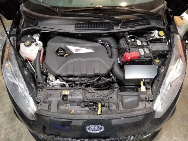

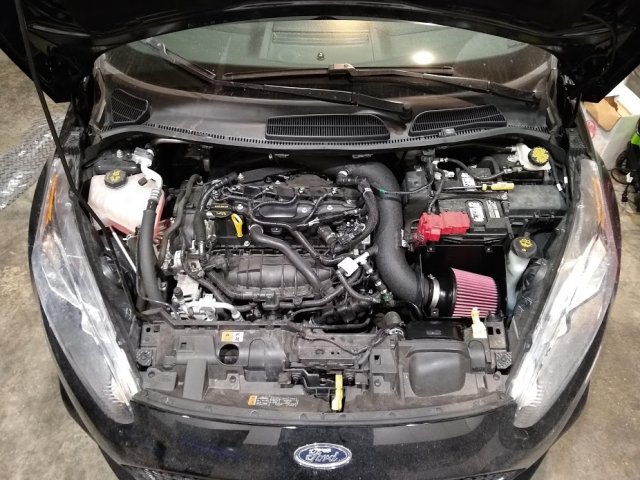

I have the Mishimoto MMAI-FIST-16-WRB on a completely stock engine. Butt dyno reports a little gain. Noise is not as much as I wanted.
Has an airbox, cone filter, metal pipe about 2/3 of the way into the turbo and then silicone hose 1/3 of the way. Comes with an evap fix and I have never had a code in 3k miles. Bought from Whoosh. Very satisfied but wish there was a bit more vroom vroom sounds.
