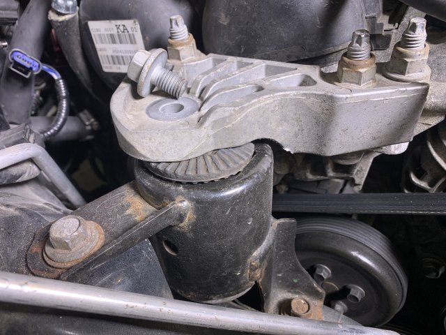

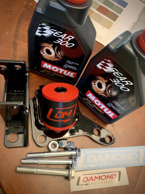

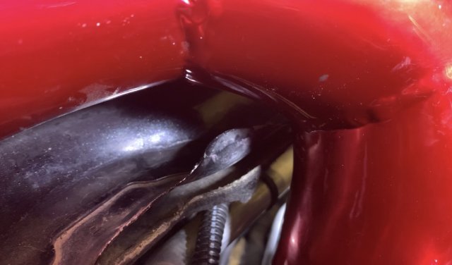

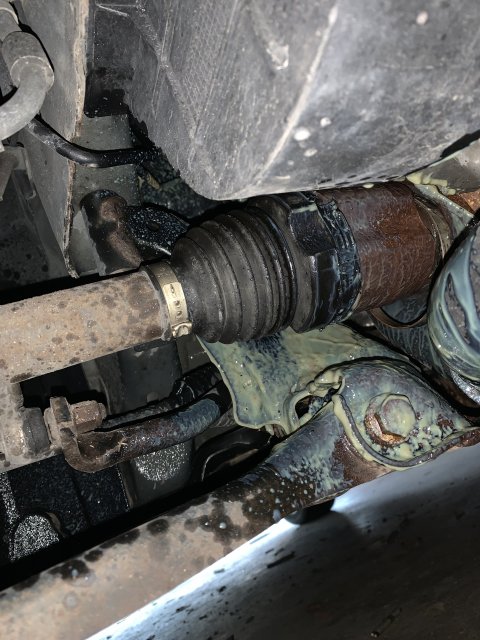

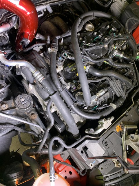

Broke my passenger side motor mount center bolt, sheered right through and sent the motor real good back into my firewall. In this event my passenger CV inner boot tore and clamp flew off by slamming into the passenger side hub/knuckle assembly. Sent a big ol mess of grease all over the car. I took apart my cowl and inspected the intake and surrounding. The lower cowl kinda got crushed by intake and the intake took a little abuse as well. Will be needing to take the intake and inlet elbow off to clean everything. I ordered up a new Damond motor sports passenger side motor mount and new passenger side CV shaft + some Motul 300 fluid for a gear box fluid change.

That looks nasty but look at the bright side, that part of the car is now rust proofed.:rolleyes:
Haha! You’re totally right, I wish it was that easy! It’s going to be a nice clean up session once I get under there on Thursday.

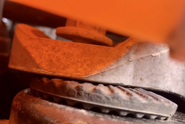

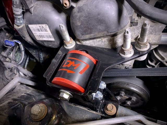

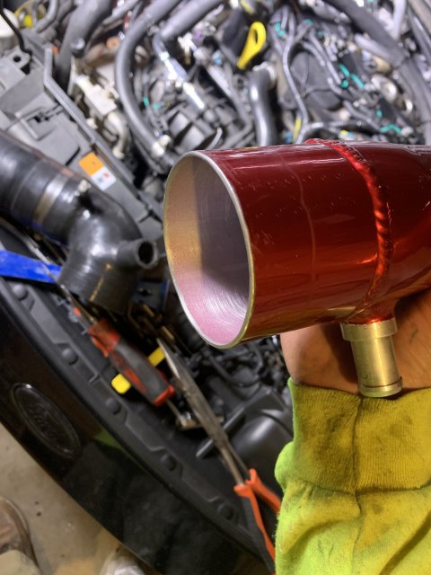

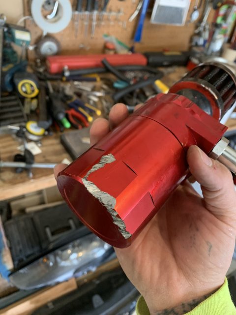

Got half the repair goods yesterday... drained my gear box, removed all turbo ducting and intake, removed passenger side axle, permanently deleted my catch can because it was getting eaten by my alternator. Half assed cleaned everything I could. Noticed my intake was sitting too high in the cowl and also hitting the VVT solenoid connector... had to cut another 1/4” off the 2J to reduce its height. Got it cleaned up, everything now fits much better. The old motor mount definitely sheered the bolt. New Damond motor mount looks great and hopefully works just as well... hoping not too much false knock from the mount to piss off my tuner. Headed home now to throw in the new axle and fingers crossed once I drive nothing else shows it’s face.

You did not HEAR that catch can being ground down? [crazyeye]
Let us know how the Damond mount works out (NVH levels, etc.). [thumb]
It’s honestly hard to say what noise is what! The cars pretty loud and other things were broken so likely miss identified that noise. I tried to remedy it with some worm clamps to hold it up once, but no dice... I’ll just junk it. Probably don’t need it now with aux fuel anyways. I’ll certainly keep you all posted about the motor mount... it seems promising, but I have nothing to compare it to other than stock.

Damond claims that this mount addresses the engine assembly's torqueing motions/forces in the same direction/plane in which they are occurring. [dunno] [wink]
I’ll tell you what though, my little fiesta turned into a train after putting this thing in lol. It vibrates pretty beastly now. Sunroof shakes, car jiggles at idle. It certainly plants the wheels though and the car feels much more concrete and responsive. I like it! It does have a break in period so it may mellow out some, but it’s definitely not a stock comfort level mount. I don’t know what other aftermarket mounts feel like, so I can’t compare... I’d imagine most of them would vibrate about this much I suppose. Feels more racecar to me now though haha, I don’t mind it at all.

Great build! Of course I discover the Damond PMM after I order a new bolt and the Powerflex inserts :oops:.
Thank you! And from what I take it you’ve actually equipped the appropriate setup. Apparently these type of mounts produce phantom/false knock in cyl 1 because of the added NVH and they give your tuner a hard time because the motor wants to pull timing. You sir, have a solid mount setup and there’s nothing to worry about!
